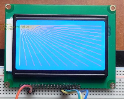

There are some new 126x64 GLCDs available to replace the venerable KS0108 based ones. The new ones use the ST7920 controller, still 5V unfortunately, but I'm connecting direct to the MM without problem as all connections from the MM are outputs.
e.g. this one
These can be used in SPI mode, 4-bit parallel, and 8-bit parallel (like the older ones).
I've modified the graphics routines to drive this display in SPI mode using only 4 pins on the micromite.

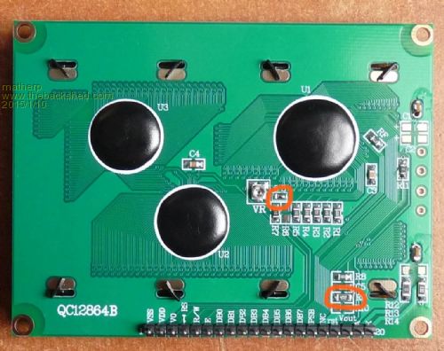

The display I received needed a minor mod to work in serial mode. The resistor circled in the picture was originally 0-ohm. This resistor is a pullup on the PSB input to the display (pin 15) which puts it into parallel mode. Before I discovered this, when I tried to tie PSB to 0V to put the display into serial mode it shorted out the power supply through this resistor
I replaced the 0-ohm part with a 4K7 resistor so I could then tie PSB to ground.
I made one other mod circled in the picture. There is a 2 way shorting link that selects between an external contrast potentiometer and using the on-board one. Changing the link as pictured enabled the on-board one (next to the link).
The board has a 330ohm dropper resistor for the backlight so the wiring is really easy.
GND - pins 1, 15, 20
5V - pins 2, 19
RESET pin 17 connected to micromite (pin selectable in the software)
RS pin 4 connected to micromite (pin selectable in the software)
RW pin 5 connected to SPIout on mixcromite
E pin 6 connected to SPIclk on micromite
The picture doesn't come across very well but the display has very good contrast and viewing angle.
The demo program includes my normal test harness for monochrome displays and the
only changes from the OLED code are the initialisation and a different Cfunction to construct the output string for sending to the display.
2015-01-10_115226_st7920.zip
