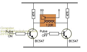

Hi folks.
I have some single-coil latching relays. These are the type where you put the juice on the coil one way, and the relay contacts close. To release, you have to put the juice on the relay coil in reverse polarity.
There are plenty of ideas and circuits very similar to this one I found on the net:
The theory is sound, and nice and simple etc.
My only concern is back-EMF. Normally, in a relay circuit with a driver tranistor, you would put a back-EMF diode across the coil. However, that only works if the juice to the relay is always going to be in the same polarity - you can't do that with a coil where you flip the polarity around.
So, can anyone suggest anything better, or perhaps a way to improve on this circuit I found?
Perhaps I am being over-cautious, but back-EMF is a transistor-killer!

Posted: 04:33am 03 Feb 2015
In this circuit wont the two 47 ohm resistor in series (94 ohm) that are effectively in parallel with the coil suppress the back-EMF voltage?

Posts: 11721
Posted: 04:56am 03 Feb 2015
You can use a bidirectional transient voltage suppressor (TVS) e.g P6KE7V5 would be suitable for 5V operation - they are available in a wide range of voltages

Posts: 6561
Posted: 08:25pm 03 Feb 2015
I would go with a back-EMF diode across each 47R resistor.
For each 'direction', the diode will look like it's across the coil in series with the other 47R.
That should protect the transistor but like most of the other responders, I don't like the circuit much at all and would prefer the two coil relays.
If I has a draw full or them, I would be tempted to experiment...

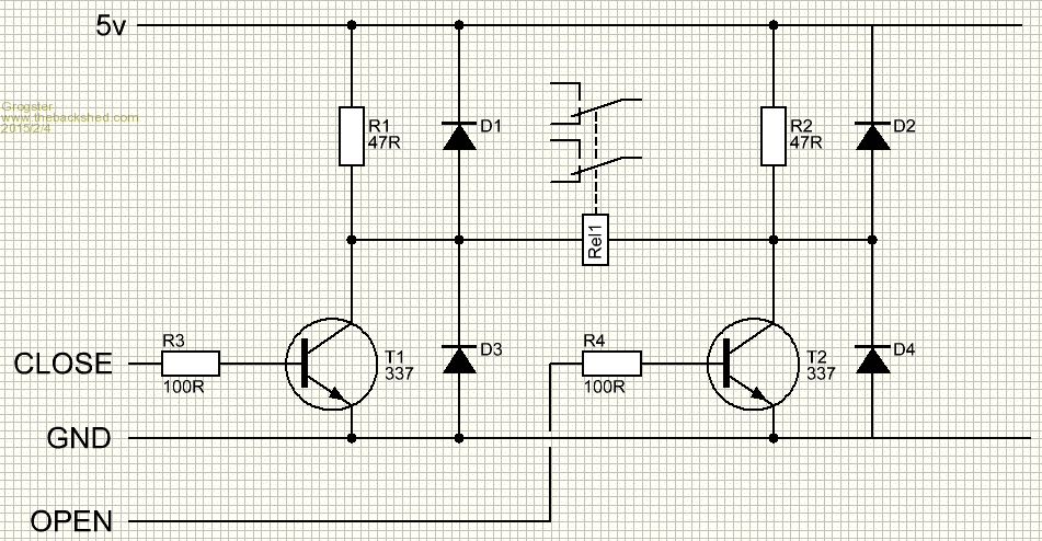

Posts: 10006
Posted: 01:28pm 04 Feb 2015
...as we all know, twin-coil latching relays won't have this dilemma at all, as each coil has it's own transistor and back-EMF diode.
I have about 40 or 50 of these relays in a box. I bought them ages ago, thinking that it may be handy to have some latching relays. Absolutely no thought whatsoever was given to how to drive them at the time!
As per my usual motivation at the time - they were very cheap(but still new), so I thought: "I might need some latching relays one day", and grabbed them.
I will experiment.
EDIT: How about this revision of the circuit?
All diodes are standard 1A type. I stole this concept from the internal schematic of just about all H-bridge motor driver IC's. Those diodes should clip anything one would think.
Thoughts?
Opinions?
Edited by Grogster 2015-02-05

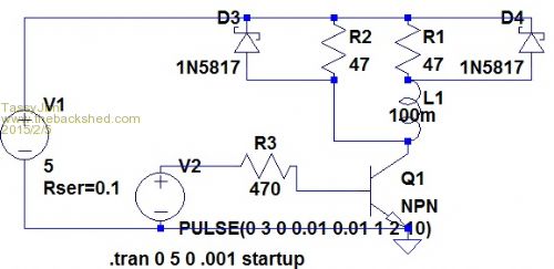

Posts: 6561
Posted: 03:59pm 04 Feb 2015
I did a spice simulation with 2 diodes. No idea what the inductance of the coil is so the actual spike size is irrelevant but two diodes (I used schottky diodes) did do the job.
Drawing the circuit this way makes it look like a conventional relay control.
For each direction, one diode is forward biased during the back emf period.
Both diodes are reverse biased during the time the transistor is 'on'
I would still like to do a real life test 'cos I don't trust my simulations that much.
Conclusion - the relays Grogster has should be OK to use.

Posted: 09:02pm 18 Mar 2015
  disco4now said   In this circuit wont the two 47 ohm resistor in series (94 ohm) that are effectively in parallel with the coil suppress the back-EMF voltage?
Gerry
Yes, that's right.
If the supply voltage is 12 Volt, then the relay current will be 12/(120 + 47) = 72 mA.
When the transistor is turned off, then this current will continue to flow initially & decay exponentially.
The voltage across the 47 Ohm resistors will be 0.072 * 47 = 3.4 Volt. (i.e. 3.4 V across each resistor giving a total Back EMF of 3.4 * 2 = 6.8 V if measured between the 2 collectors)
Thus the collector voltages will be 12 + 3.4 = 15.4 V for one transistor & 12 - 3.4 = 8.6 V for the other.
Therefore neither transistor will be damaged.
redrok
Joined: 15/09/2014
Posts: 209
Posted: 08:52am 19 Mar 2015
Hi larny;
Gerry
Yes, that's right.
Not quite.
The relay, TXD2-L-4.5V, has a coil resistance of 135ohm. Lets use a supply voltage of 5V, load resistors of 47ohm, assume a VCEon of 0V, and initially eliminate the snubber diodes.
  Quote  If the supply voltage is 12 Volt, then the relay current will be 12/(120 + 47) = 72 mA.
The coil ON current will be:
5V / (135ohm + 47ohm) = 27.5mA
  Quote  When the transistor is turned off, this current will continue to flow initially & decay exponentially.
Since the peak current will be 27.5mA the voltage across the 2 resistors in series will be:
27.5ma * (47ohm * 2) = 2.58V for both
However, each resistor will have only half of this:
2.58V / 2 = 1.29V on each.
  Quote  Thus the collector voltages will be 12 + 3.4 = 15.4 V for one transistor & 12 - 3.4 = 8.6 V for the other.
In this case:
The driven transistor when turned off will have:
5V + 1.29V = 6.46V
And the passive transistor will have:
5V - 1.29V = 3.71V
And after the current collapses they will both have 5V.
  Quote  Therefore neither transistor will be damaged.
I agree.
To go further:
This example has a coil resistance of 135ohms.
The spec says the relay has a "Pickup Voltage" of 75% of the rated voltage, 4.5V in this case:
75% * 4.5V = 3.375V relay pickup voltage in the spec.
Lets calculate this circuit's pickup voltage:
5V * 135ohm / ( 47ohm + 135ohm) = 3.71V circuit's pickup voltage.
Getting kind of close! Not quite high enough to meet speck but would probably work.
I guess I would use a smaller resistor, possibly 43ohm or 39ohm.
And of course one should figure in the tolerance of the 5V supply and the non 0V of the transistor.
BTW, why not use the venerable 2N7000 MOSFET.
Edit:
I have to add a comment:
The reason no snubber diodes are required in this example is there is no value of resistance pairs that will allow the the kickback voltage to go negative on the passive transistor nor greater than 2 times the voltage rail on the driven transistor. Cool huh!!!
Of course, there are other problems but never reverse polarity.
redrokEdited by redrok 2015-03-20
