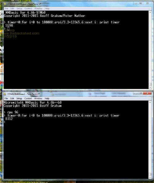

I spent yesterday getting the rudiments of the Micromite code working on the STM32F407VG chip (1M flash, 192K RAM, 168MHz clock, hardware FPU).
I'm using one of the very cheap STM32F4-discovery boards as the development hardware and the free CoIDE IDE and GCC32 compiler (same compiler as Microchip use)
I've got to the point that the console is working and I've set up a 1msec interrupt timer. Basic is operational from the command line but there is no facility to save a program.
Although there is 192K of memory, this is split into 128K and 64k sections which makes it more difficult to use. At the moment the code is only using the 128K bit.
Before putting in any more effort I though I'd try and run a simple benchmark to test the comparable performance - results below.
Basically the performance appears to scale pretty much 1:1 with the relative clock speeds. Comments?
If its not clear on the picture the times are:
ARM@168Mhz 5598
470@96Mhz 8712
170@48MHz 13626
Edited by matherp 2015-02-20
