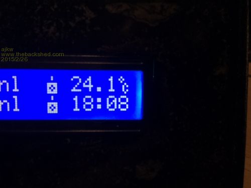

Posted: 09:21pm 25 Feb 2015
Whilst this doesn't suit the OP's application and he already seems to have found a way I just thought however I would add this as a way for a degree symbol on a LCD character display.
Cheers.

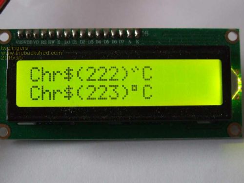

twofingers
Joined: 02/06/2014
Posts: 1752
Posted: 05:12am 05 Mar 2015
