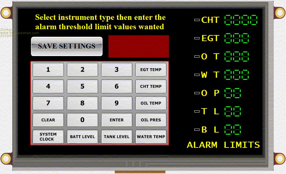

Posted: 01:00am 06 Mar 2015
Sweet Matherp..!
I didn't know you were an airplane Guy...! Awesome... Right in the middle of a NICE GA build... Yes I know... This project WILL consume your time..! GO FOR IT..! I have built 2 Ultralights in the past, so I know how things go...
Keep working on your dream machine brother..!!
