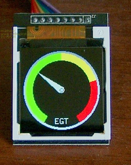

I'm playing with the development of some instruments for measuring things like Exhaust gas temperature (EGT), Cylinder head temperature, RPM etc. The display I'm using is the ILI9163 which is small (the unit must fit in a 2" circle) and bright. The code should run on an ILI9341 but I haven't tried it. However, as always, my coding is not complemented by my complete lack of artistic ability.
The display must be easily visible and the needle position must refresh without too much flicker. This is the best I have been able to come up with:
Comments, criticisms and alternative code greatly appreciated.

Hi Matherp, this looks real nice. What kind of response (speed wise) are you getting with the needle? Is there any way you could video clip it? (Not that your aren't busy enough already)
EDIT...
Would you put a changing numerical value in the screen also?Edited by viscomjim 2015-06-01
Posts: 11512
Posted: 07:22am 31 May 2015
Time to reposition the pointer is between 7 and 8 msecs

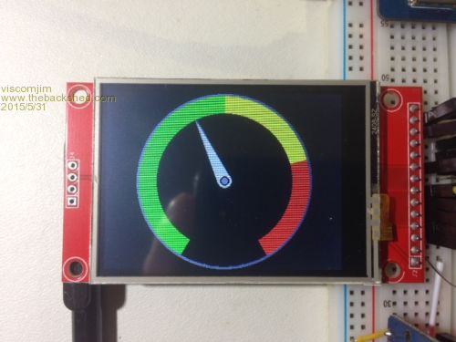

Hi Matherp, I tried your code but am running a ILI9341 display 2.4". This is what I got...
CPU exception #6 (bus error on ifetch) at address 0x383420
Processor restarted
Posts: 11512
Posted: 07:54am 31 May 2015
Are you running 4.7beta 8?
Video here Edited by matherp 2015-06-01
viscomjim
Joined: 08/01/2014
Posts: 925
Posted: 07:56am 31 May 2015
OOOOOOOOOPPPPPPPPSSSSSSS!!!!! My Bad. Running beta 3. Will update and tried again...
Loaded beta8 all is well. Here is a pic on the 2.4" display, the picture does not do it any justice. It looks really clean. You can't see the lines that are showing up in the picture. It just looks great!

Works well and looks good on my ILI9341 2.8" Peter - but there's a strange effect on the needle. It moves smoothly but bulk sections of the colour flicker between white and grey as it moves around. Actually it's not so much a flicker as sort of random, but seems to be the same each time it's run. At one point it travels about 30 deg. with half the needle white and half grey - that's across the needle. At other times it's more longitudinal or at angle to the needle axis and random.
Maybe a raster interference or timing issue?
Greg
Edit: Just tried it with the 2.4" screen and have the same effect.Edited by paceman 2015-06-02

It runs on the 2.8 ILI9341 but as Greg has found there is an annoying grey artifcat when it draws the white needle..
Also I dont get the EGT or the value under it.. I get the same as the picture Jim added..

There appears to be a bug (or is it a feature) in 4.7b8 with the OPTION LCDPANEL command..
If the option has been set already trying it again or trying to change the orientation (landscape/portrait etc) returns an INVALID PIN error..
It requires an issue of OPTION LCDPANEL DISABLE to change it to a different orientation..
It may be by design..
@Peter, I noticed in your vid clip that the orientation was portrait..
I set to portrait and the grey artifacts were no where near as bad but it was still there and in reverse portrait it was pretty bad and maybe a bit worse than Landscape..
Also in portrait mode I get the EGT but no numbers...

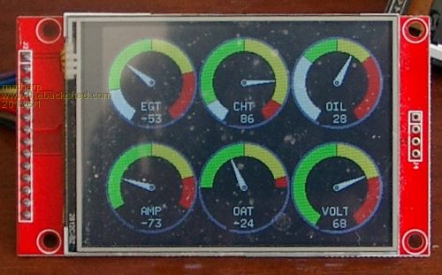

This is how Geoff has designed it, I have asked for a rotate command to be included but this is still on the to-do maybe list.
  Quote  Also in portrait mode I get the EGT but no numbers...
The version posted above was before viscomjim asked for numbers which I then added and posted the video. New code below.
  Quote  I would suggest that if a guage goes into the RED that a flashing RED background would be good to draw attention to the fact.
Good idea I'll have a look at that
  Quote  Maybe add the "white" section on the bottom of the gauge scale.
This is easy for you to do or for any colour changes just modify the constants that define the segment start points and add another segment call to draw it.
  Quote  Actually it's not so much a flicker as sort of random, but seems to be the same each time it's run. At one point it travels about 30 deg. with half the needle white and half grey
This seems to be an artifact of the way the pixel updates take place relative to the raster refresh on the ILI9341. There is almost no effect on the ILI9163 and the ST7735 is about halfway between. I'm not sure if there is a way round this but remember at the moment the update rate is around 25 position changes/second. For a real EGT this would be 1/sec so the effect wouldn't really be visible.
Replacement main program code to display the text and numbers properly and scale the font depending on the screen size:
Option default none
Option explicit
CPU 48
Const stepsize=3
const displaystring="EGT"
dim integer lastx1, lastx2, lastx3, lasty1, lasty2, lasty3 ' Global variables to store last pointer position
Const greenstart=-150, yellowstart=0, redstart=75, blackstart = 150 ' position of display bands in degrees - must be in ascending order
Dim integer i, radius, firsttime=1, needlelength, fontmult
dim s$
If MM.HRes<=MM.VRes Then ' set the radius of the display less the "bezel"
radius=MM.HRes/2-4
Else
radius=MM.VRes/2-4
EndIf
if mm.hres>160 then
font 1,2
fontmult=2
else
font 1,1
fontmult=1
endif
needlelength= radius\5*4-1
Circle MM.HRes\2,MM.VRes\2,radius+3,0,,RGB(210,210,210),RGB(210,210,210) 'background to creat the bezel
segment(MM.HRes\2,MM.VRes\2,radius,greenstart,yellowstart, RGB(green))
segment(MM.HRes\2,MM.VRes\2,radius,yellowstart,redstart, RGB(yellow))
segment(MM.HRes\2,MM.VRes\2,radius,redstart,blackstart, RGB(red))
segment(MM.HRes\2,MM.VRes\2,radius,blackstart,greenstart+360, 0)
Circle MM.HRes\2,MM.VRes\2,needlelength+1,0,,0,0
text mm.hres\2-len(displaystring)*4*fontmult,mm.vres-fontmult*33,displaystring ' string centred in black segment
do ' run the pointer backwards and forwards
For i=greenstart To blackstart-1
s$=str$(i,4)
needle(MM.HRes/2,MM.VRes/2,needlelength,i,RGB(white))
text mm.hres\2-len(s$)*4*fontmult-4*fontmult,mm.vres-fontmult*19,s$ ' string centred in black segment
pause 10
Next i
For i=blackstart-1 To greenstart Step -1
s$=str$(i,4)
pause 10
Next i
loop
End

Posts: 11512
Posted: 03:27am 01 Jun 2015
Here is a new version better implemented that supports multiple gauges on the same display
All the colour segments, locations and sizes are now parameterised so it is much more flexible.
I've also re-written the triangle drawing routine to output multiple triangles in a single call to the Cfunction. This allows the blanking pointer and the re-draw to be done together as fast as possible. This has reduced the appearance of the artifact but it is still there. The ili9163 is much the best display for a single gauge but the bigger displays are more flexible as above.
Option default none
Option explicit
CPU 48
Const stepsize=1
const maxgauges=8
dim integer x(maxgauges), y(maxgauges), radius(maxgauges), fontsize(maxgauges)
dim integer lastx1(maxgauges), lastx2(maxgauges), lastx3(maxgauges), lasty1(maxgauges), lasty2(maxgauges), lasty3(maxgauges)
dim integer whitesec(maxgauges),greensec(maxgauges),yellowsec(maxgauges),redsec(maxgauges),blacksec(maxgauges)
dim integer i,j
dim s$
initgauge(0,53,60,49,1,-150,-100,0,75,150,"EGT")
initgauge(1,159,60,49,1,-150,-120,0,120,150,"CHT")
initgauge(2,265,60,49,1,-150,-50,0,50,150,"OIL")
initgauge(3,53,180,49,1,-120,-120,0,75,120,"AMP")
initgauge(4,159,180,49,1,-90,-90,0,75,90,"OAT")
initgauge(5,265,180,49,1,-150,-150,0,75,150,"VOLT")
for j=0 to 5
i=rnd(22)* (blacksec(j)-whitesec(j)) + whitesec(j)
s$=str$(i,4)
needle(j,i,rgb(white),s$)
next j
pause 500
loop
End
' Routine to initialise a gauge
' Parameters are:
' gaugeindex
' x-coordinate of centre of gauge
' y-coordinate of centre of gauge
' radius of gauge

Just had a chance to try this...
HELL YEAH!!!!!!!!
uMite just stepped up!!!!
Can't say thanks enough! I can't even image where this will go....

Wow, that's looking pretty amazing Peter - you, Geoff and Peter Carnegie should take a bow - and all on a $10 display with a $5 MX170 running the brilliant Micromite II MMBasic with CFunctions!
Greg
BTW, I can't see those artifacts at all with this version on the 2.8" using ILI9341 controller.

I also confirm no grey artifacts seen but I do see the V and the T in Volt get over written if the value is too low or too high. But then this is a demo of course..
