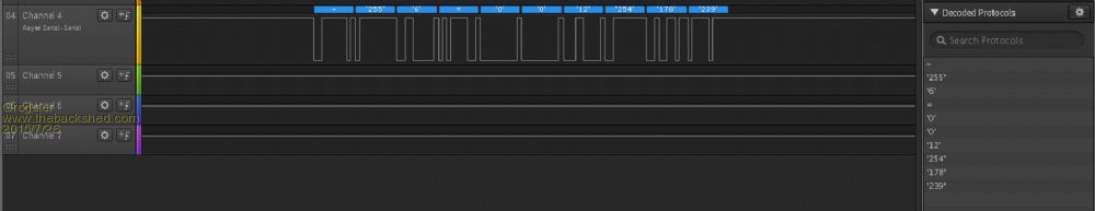

Posts: 10075
Posted: 12:27am 26 Jul 2015
Yes, the module does definetly output several bytes at the end of each file played:
Three different files played, these are the bytes sent by the module at completion of playback, and the data is different for each one with the exception of the first few bytes of the message, which seem to always be the same.
I can't find any information about what any of this means though.....Edited by Grogster 2015-07-27

Mr Grogster,
If you have the time would you output a trace but with each char showing the Hex value.
Thanks,
John B

@ VK2MCT: Yep, will do that tomorrow. Even the GIF's are a little fuzzy. I can link to dropbox versions for better clarity, if that is desired by anyone...

Posts: 10075
Posted: 02:12am 28 Jul 2015
Here is a GIF of the output of the module in HEX as requested.
Note that this data changes with every file played, but the first few bytes seem to be the same. I must have a read through the manual that Rob found......
Catalex TXD GIF image example
VK2MCT
Joined: 30/03/2012
Posts: 120
Posted: 04:03am 28 Jul 2015
I've done a fair bit of translating (google xlate) of the Japanese Manual
Manual example in HEX
7E FF 06 3D 00 00 02 xx xx EF TF card to play the first two completed
The GIF has (all hex)
7E_FF___________06__________3D_______00_00__0C_____FE_B2___EF
Std_start_chars___Bytecount___Command__?__?___Track__CRC_____Endchar
So this string seems to mean that the 0C th track has finished playing.
0C hex = 12 decimal.
So the 12th track has finished playing.
Could this be true ???
No warranty is implied.
John B

Posts: 10075
Posted: 03:01pm 28 Jul 2015
@ VK2MCT - Yes, I played track 12 for that test - well done, and that does correspond with the track I played for that test image last night.
