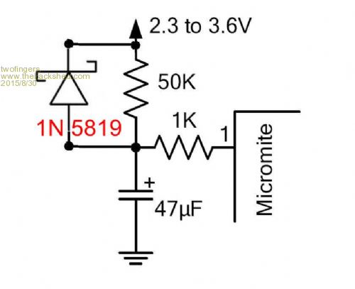

Has anyone tried using the delayed start up circuit shown on page 30 of the uM user manual 4.7 beta? Maybe this would help in these cases.

Posted: 06:08am 29 Aug 2015
Hi Geoff,
  Quote   MMBasic cannot prevent this so I agree with Grogs that you need something to hold the chip in reset until the power has settled.
Do you think a "Delayed Start Up" (as described in the MMBasic manual) will do the same?
MichaelEdited by twofingers 2015-08-30

A delay start will not suffice.
There are lots of brownout situations that possibly can cause the same.
A supervisory chip takes care of that too.

  Geoffg said  MMBasic cannot prevent this so I agree with Grogs that you need something to hold the chip in reset until the power has settled.
Geoff
While I understand that a supervisory chip would be the gold standard solution, I still can't understand why using the delayed start wouldn't help with this particular problem.
  Quote  Sometimes I have to use one hand to connect the plug and jack as the other hand is holding down a switch or something. When I do that, it gets a bit tricky to make the connection and I am sure that I am literally turning the unit on and off several times very quickly as I fumble to get the plug into the jack with one hand.
The only way to know would be to try and see if the delayed start circuit helps in this particular case.

  twofingers said  Do you think a "Delayed Start Up" (as described in the MMBasic manual) will do the same?
Yes, something like that would work for WW's particular problem although you would need to add a diode to quickly discharge the capacitor when the power momentarily failed.
There are many ways that the power can cause issues and many solutions. A supervisor chip is one of the better solutions.

Posted: 12:32am 30 Aug 2015
  Geoffg said  Yes, something like that would work for WW's particular problem although you would need to add a diode to quickly discharge the capacitor when the power momentarily failed.
A schottky diode? In this way?
(Note: Image mainly from Micromite MMBasic Ver 4.7 Beta Manual)
Michael
