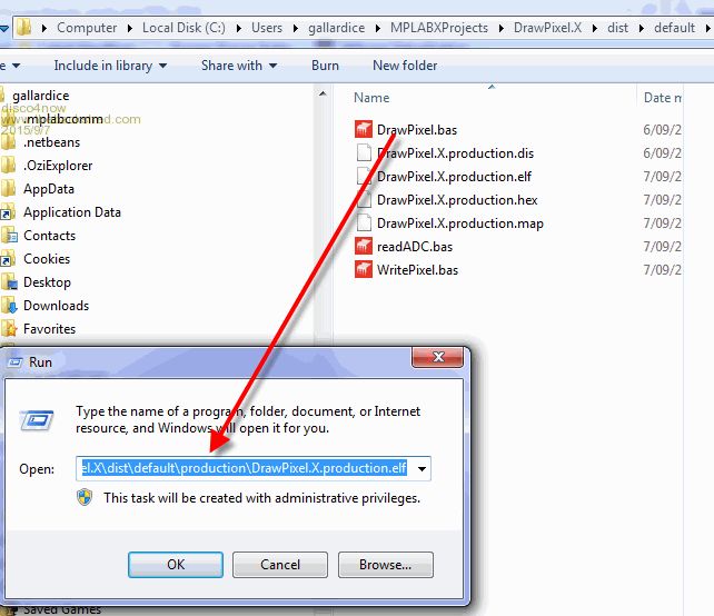

Unfortunately the support site for CFunctions is no longer online so I have programmed a clunky but workable replacement for CFuncGen
This is written in MMBasic V4.5 for DOS. Unfortunately this doesn't support OPTION EXPLICIT or INTEGER datatypes so some of the variable usage may be a bit unclear. However, I was impressed how reliable MMBasic for DOS is doing some quite complex logic.
The program reads the .ELF file created by MPLabX and outputs the CFunctions in Basic format.
There are simple instructions for use in the file header. If you can write CFunctions you should be able to work out how to use it, but any questions do ask.
I used this document as my source of information on the .ELF file
The program is tested on a selection of my CFunctions including display drivers and works properly on the tested examples but please let me know if you find any bugs. The program includes a fairly primitve mechanism for replacing Jump and Link instructions which are not position independent with Branch and link which are. This has only been tested with backwards references, e.g. calling the first function in a merged file from the second.

Thanks for replacement CFunctGen. I have used your first posted version in anger and have successfully called DrawPixel using the MMBasic API.
I found it quite convenient to use via MMBasic, just run up a second copy of MMBasic and loaded CFunctGen.bas , remark out the prompts and hard code your file names etc and save a copy with the project name appended. This makes it easy to run multiple times as you do in development.
A good way to get long windows directory + file names into the clipboard is to open up the run dialogue and then drag the file to the input field. You can then get it from there into the clipboard and paste where you want.
So after being away for a couple of months away I am nearly caught up.
