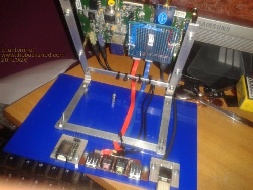

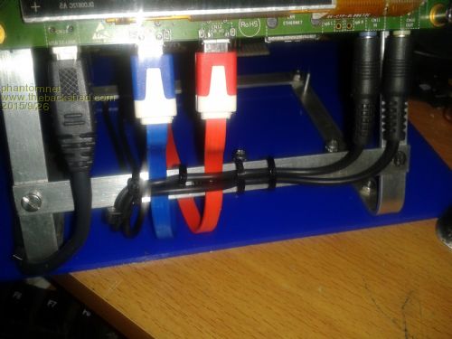

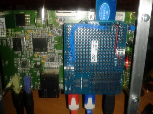

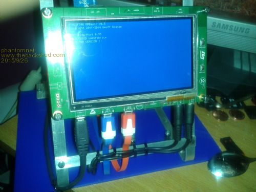

This is my test setup:
STM32F746 Discovery
Arduino proto shield
CC1101 board
Rear view
Front view
Connectors
Prototype Shield
Work in progress:

Humm... Awesome setup...! But what type of display unit are you using..? I see ST on it... Not sure how it interfaces... I have a discovery board, but no touch display for it... Looks like the firmware package is shaping up nicely..! I was wondering if support for the A/D and D/A hardware would be included...
