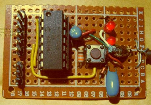

Hi Jean,
in the meantime (actually since october) I have my/(your) 1455-Programmer ready (WinXP).
I did not try the pic32prog with it yet.
But maybe I need some more informations, please.

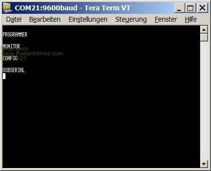

Can I download a manual for this and a USB-driver for Win7?
If not, how can I use the MONITOR and CONFIG mode (maybe this are dummys only)?
The baud rate control has to make at the driver window?
Regards Michael
MicroBlocks
Joined: 12/05/2012
Location: Thailand
Posts: 2209
Posted: 09:48am 27 Jan 2016
The XP driver i posted here also works fine in windows 7.
Only two modes are active. USBSERIAL and PROGRAMMER. The other two were placeholders for future extensions.
It will be the easiest to use when you know which LED is on in what mode, then you don't need a terminal to know in what mode it is. It will always startup in USBSERIAL mode.
When programming a baudrate is not necessary as it will be using the USB port directly.
In USBSERIAL mode you can change the baudrate in your terminal. For the MicroMite you should use 38400.
If you put it in PROGRAMMER mode you can then use pic32prog

twofingers
Joined: 02/06/2014
Posts: 1566
Posted: 12:07pm 27 Jan 2016
Thanks Jean!
Yes, the XP driver also works fine in windows 7/64 (got a installer warning/ignored).

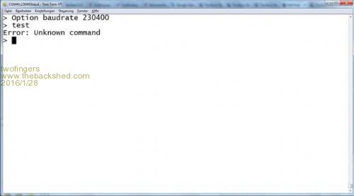

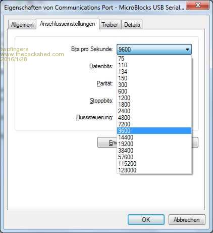

I tried the usb-serial mode. Works very well, but maybe you should mention, do not use more than 128000 baud! Or change the code to ignore baudrate settings above 128000?
The programmer testing follows.
Michael

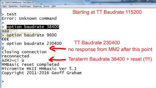

Joined: 02/06/2014
Posts: 1566
Posted: 03:49am 28 Jan 2016
  MicroBlocks said   I have tested until 512000 and it worked ok, [...]
Uhh, I did not expect that.
here is a screenshot from my USB driver propertys window (Win7/64).
  MicroBlocks said  Also things like cable length/quality becomes an issue.
Keep the wires short and if you need more length make the USB cable longer.
Serial wires are 200mm, USB cable is > 1500mm (soldered to the PCB).
This is what happens (starting at 115200 Baud):
Please note, I'm not unhappy with 115200 Baud. It is just something you have to know.
Michael
Edited by twofingers 2016-01-29

Posted: 05:02am 28 Jan 2016
The 512k was not with a Micromite but with another pic with my own code.
I will test it again with a MicroMite soon. I did test it until 115200, i was under the impression that was the highest one supported on the Micromite, but i just checked the manual again and indeed it should be able to go higher.
It does get more critical at higher speeds and without a crystal on the USB/Serial it might get tricky.
Posts: 10180
Posted: 06:20am 28 Jan 2016
I can confirm the Micromite console doesn't work at 230400 baud (at least on any variant of USB adapter I've tried).
twofingers
Joined: 02/06/2014
Posts: 1566
Posted: 06:31am 28 Jan 2016
Hi Peter,
  matherp said   I can confirm the Micromite console doesn't work at 230400 baud (at least on any variant of USB adapter I've tried).
I'm not sure if I understand you right. I've used my MMs many times at 230400 baud with my cheap CP2102 USB-serial adapters.
Michael
