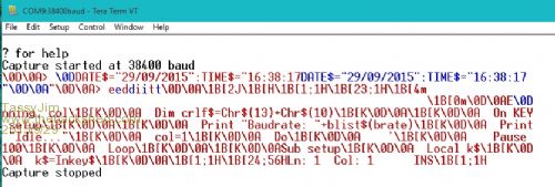

I was going to use the PC to monitor my micromite communications but I thought that that was not in the right spirit.
So here is a program that runs on a MM+ and can monitor a serial port in both directions.
You connect COM1 Rx to one of the RX/Tx lines to monitor and COM2 Rx to the other line.
Use up/down arrows or U and D to set the baud rate.
S to start and X to stop capturing.
Non printing characters are in HEX preceded by a backslash'\'
a '\' in the normal text is not treated any special way.
One direction is in red and the other in blue.
If you are using a LCD to monitor with, you can rem out the three lines that set the VT100 colours.
You might also want to reduce the line length (maxcol) to suit.
I was going to use a MX170 but I wanted the higher baudrates that the 470 offers.
