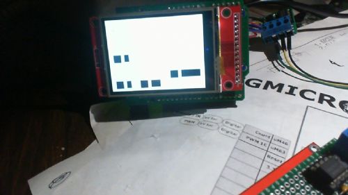

I am getting strange results with an ILI9341 TFT after issuing the LOAD IMAGE command.
The TFT is 320x240 pixels, and has been tried on R & RL orientations.
I am using a test bitmap of a red heart (filled) on a white background (and saved as 320x240 pixels).
First time, the BMP loaded rows of white pixels up to the bottom of the heart, then done a couple of pixel rows (continuing the red pixels) ok, then all other pixel rows (or red pixels making up the heart) were offset resulting in a 'scrambled' image.
After re-issunig the LCDPANEL command to try different orientations, I now only get the 'LOAD IMAGE' command to respond about 10% of the time (still drawing image incorrectly). The 90% of the time it doesn't draw anything, it just hangs after pressing the Enter key. Ctrl-C has no response; I have to reset.
I have tried multiple BMPs; all created in Windows Paint. I have no issues with BMPs generated for the SSD TFTs so assume this is an ILI9341 'issue'.
Has anyone else tried a ILI9341 on B36 - if so, did you see any strange behaviour??

  WhiteWizzard said   I am getting strange results with an ILI9341 TFT after issuing the LOAD IMAGE command.
Hmm, works fine for me. This is the test image that I use: 2015-10-12_235413_tiger2.zip
Geoff
