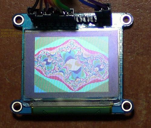

Another loadable driver, this time for the SSD1351 colour OLED. Seen here displaying Geoff's Julia. Support for this display was originally requested by WhiteWizzard
The picture doesn't do the display justice. The colour OLED gives a very bright and vibrant display. This version is again MX170 only. MX470 version by request.
sub mm.startup
dim myaddr%=peek(cfunaddr SSD1351)
dim i%=SSD1351(myaddr%,15,30,11,96,1)'Address of CFunction, DCpin, RSTpin, CSpin, vertical resolution, orientation
end sub

  matherp said   MX470 version by request . . . .
Do you mean 470 MM+? If so then Yes Please.
As you say, these displays are VERY clear & colourful so any MM+ support for them would certainly be appreciated here!
WW
Posts: 12265
Posted: 11:11pm 15 Oct 2015
  Quote  Do you mean 470 MM+? If so then Yes Please.
As requested. This has been tested on the 64-pin but should work on the 100 as well. It uses the standard MM+ pins for a SPI display as per the advanced features manual and is fully compatible with SD card use.

Posted: 03:58am 16 Oct 2015
  Quote  This version is again MX170 only. MX470 version by request.
So what needs to be done differently?
Posts: 12265
Posted: 05:52am 16 Oct 2015
  Quote  So what needs to be done differently?
Just configuration stuff. MX470 displays use SPI2, MX170 use SPI1. The pins on MX470 don't exist on MX170 (and in the case of the configurable pins, visa versa)
So it needs separate compilation and of course testing. Nothing difficult, just slog work

Posts: 3002
Posted: 04:29am 22 Feb 2016
@matherp
A quick couple of questions regarding your second post in this thread (i.e. the MX470 SSD1351 code you tested on your 64pinner)
Can I load this code into the Library so that it is 'invisible' to the end-user; and if so, does it then make all the MM+ firmware's 'graphic features' available to the end-user i.e. TEXT, BOX, CIRCLE . . . . .
I am ultimately after all the MMBASIC v5.1 built in TFT features, but on a physically smaller & brighter screen - so this OLED unit is perfect.
If all the above works as I am hoping it will do, will the GUI TEST LCDPANEL command work in the 'normal' way too?
Thanks,
WW
Posts: 12265
Posted: 06:07am 22 Feb 2016
  Quote  Can I load this code into the Library so that it is 'invisible' to the end-user; and if so, does it then make all the MM+ firmware's 'graphic features' available to the end-user i.e. TEXT, BOX, CIRCLE . . . . .
Yes
  Quote  If all the above works as I am hoping it will do, will the GUI TEST LCDPANEL command work in the 'normal' way too?
Yes

Posts: 3002
