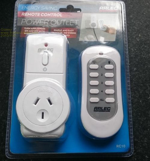

Bunnings ( also seen similar at Jaycar ) have a Arlec remote operated mains switch for under $15. http://www.bunnings.com.au/arlec-remote-control-power-outlet-_p4331239. Basically its a self contained mains switch that works via a remote control.
I'm thinking I could hack into the remote control unit, wire it up to the maximite, and this gives me a safe way to switch mains power. The customer can then just plug in a mains powered siren/bell/lamp/whatever into the Arlec switch.
No mains wiring is needed by me or the customer.

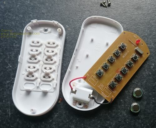

Posted: 04:58pm 01 Nov 2015
I bought a Arlec single outlet unit from Bunnings for about $13.
After testing it worked OK, I pulled the remote control unit apart to have a peek. It uses stantard pushbutton switches and runs on a 3.2 volts. When transmitting, the current is about 9mA.
Cool, this makes life easier.

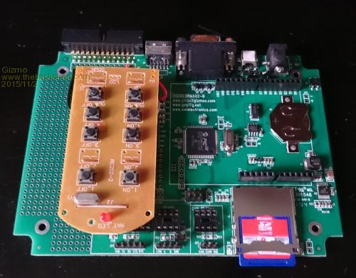

9mA at 3 volts means I can power the transmitter directly off the Maximites 3.3v supply, eliminating the need for batteries. The transmitters push buttons are floating above 0v in a matrix of some sort, so I used a couple of opto couplers driven by the Maximite to switch the transmitter functions, the On and Off buttons.
The transmitter circuit board is mounted over the "sea of holes" on the CG Colour Maximite, with a few short copper wires to hold it in place. I removed a couple of the unused push button switches and used their copper pads as anchor points
Works a treat.
