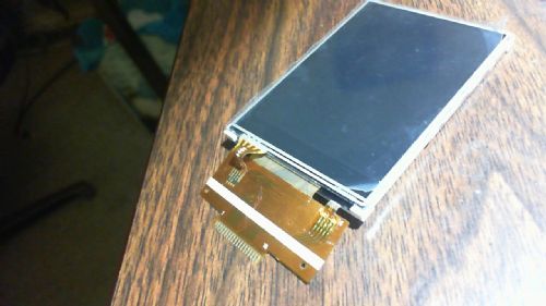

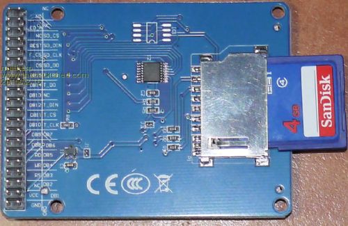

Hi there everyone, but especially matherp.
Have you, or anyone else for that matter, developed a driver for this LCD module by any chance?
This one appears to 8-bit parallel with touch for US$7.50
Also has uSD card slot, and on-board video RAM, which is an interesting twist.
It is in Arduino Shield footprint, but also looks like the connections are routed out to a 2x9.
I would be prepared to purchase and send this LCD to matherp, if he would be interested in developing a driver for it.
It would seem it uses the SPFD5408 controller chip, the datasheet for which can be found here .

I haven't got one. Also, note it doesn't have a touch controller, and the touch outputs are multiplexed with the data signals.
There is also a ILI9341 with this form factor (parallel I/F). I gave up on it because I never got the touch to work reliably.

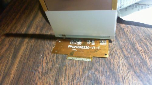

That display looks perfect. Did you do a driver for it's controller IC? (ILI9325)
Posts: 12265
Posted: 09:27am 15 Dec 2015
  Quote  Did you do a driver for it's controller IC? (ILI9325)
Yes I've done one. What MM are you looking at and what pin use? I've done PortC pins on a 44-pin (D0-D7=25,26,27,36,37,38,2,3, RS=4, WR=5, RESET=any), code attached.
64-pin with standard LCD-D0-D7, RS, WR, RESET is an easy mod.

I just received 10 of these "raw" displays from E-bay and they say it's the ILI9341 graphics driver... However, after asking the seller for some info and pin-outs data, looking at the "English" PDF file, it says it's the ILI9325 controller... Sure is a good thing you have code for both..!!
I want to create a PCB with a FFT connector to interface to this unit, making the thinnest MM touch PCB possible... I will be adding a Rs-485 comms interface to use it as a "setup controller" for the telemetry module for the EIS system... The telemetry module will be housed into a "potted" module for toughness and can't have a glass display in it as originally planned... So, since the main system data transfer buss is going to use Rs-485, I wanted to add this unit on as a slave so the end user can do the setups easily without resorting to a PC and having to setup Teraterm..Ect...
I know I will need to add a touch controller in to the design also...
I will also make some kind of interface to bring out the MM pins...
Still looking for the pinouts.. Will update later... (go bed now)
