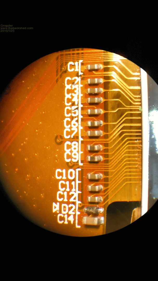

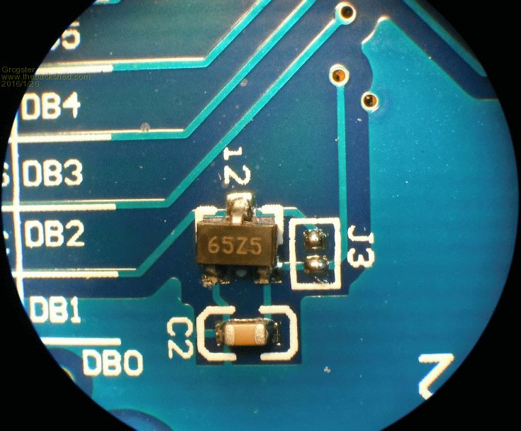

Hi folks.
I am not getting any response at all from the driver, and MMBASIC says the command to open the display is unknown.
sub mm.startup
CPU 48
LOCAL CFuncAddr%
LOCAL Retrn%
CFuncAddr%=PEEK(CFUNADDR ILI9325_V64)
Retrn% = ILI9325_V64(CFuncAddr%,4) 'CFunction address, reset pin, orientation
end sub
'sub mm.startup
' ILI9325_V64(PEEK(CFUNADDR ILI9325_V64),4)
'end sub

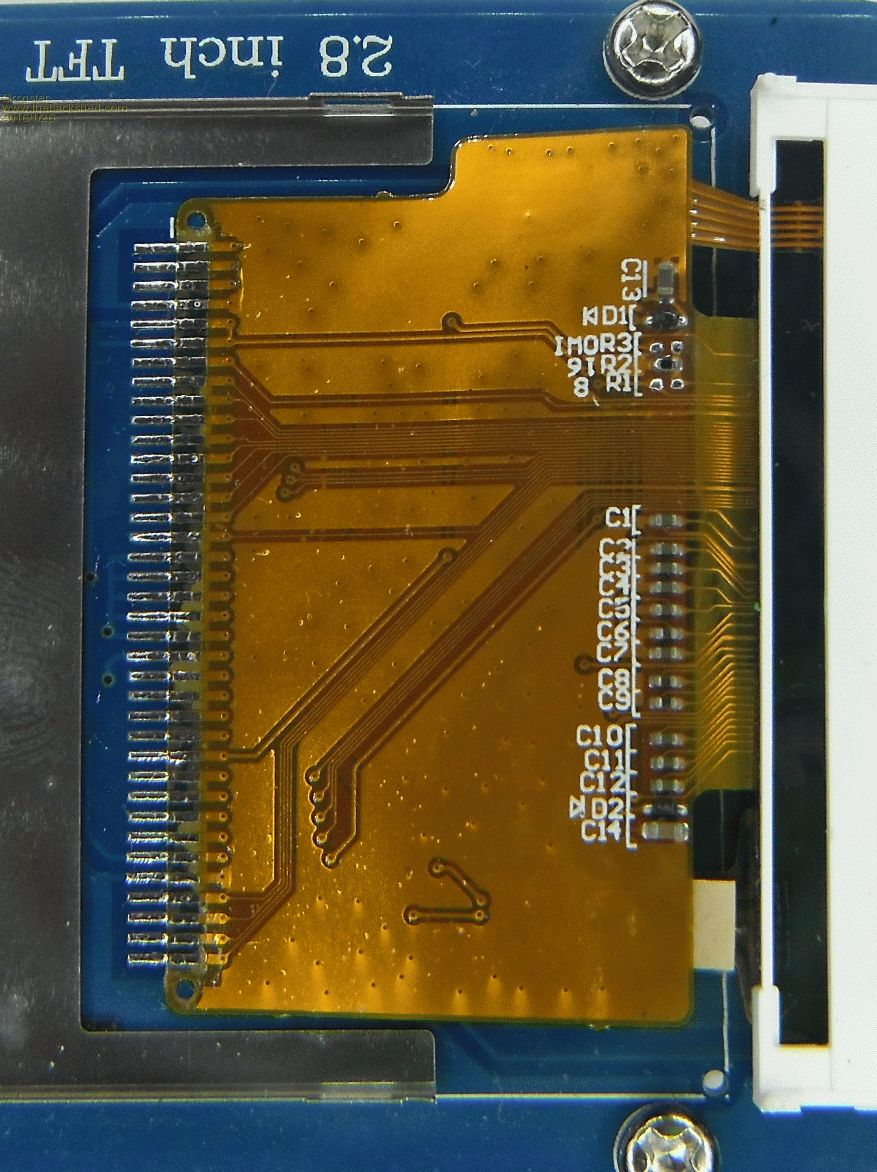

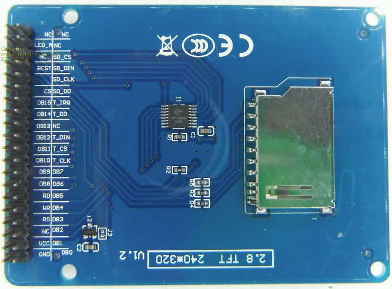

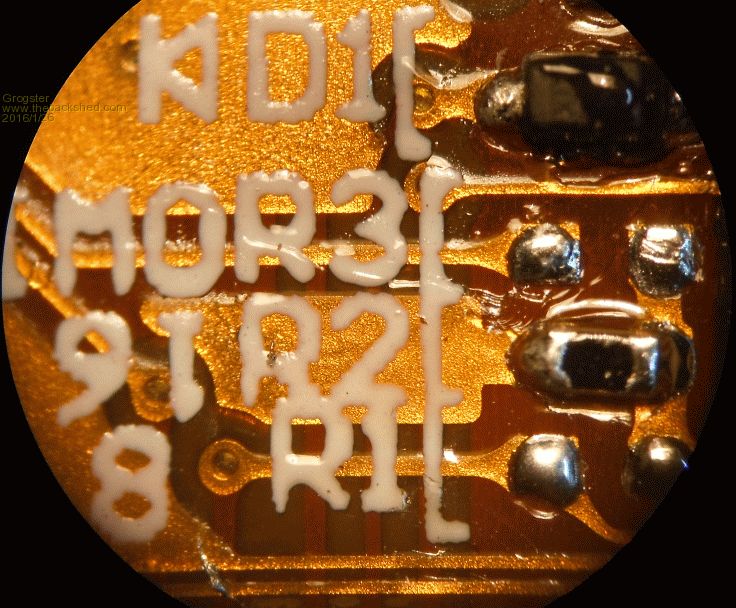

After loading this into memory, cycling power, and issuing Display.Open at the command prompt, I get a message that this is an unknown command.
Note in this version of the code, I have added in the extra startup code as suggested by matherp at the end of page 1 of that thread. I have commented-out the original lines for my own reference.
Back in that thread this driver was discussed, but there have been many changes to it over the course of that thread, and the description text I think is now also wrong with it mentioning use of pin numbers etc, which are not needed for the V64 port of the driver. However, this text is still in the driver file, and is confusing the hell out of me.
@ Matherp - could you perhaps paste a version of the code here on this thread, which I could just copy-and-paste into MMEDIT to get the display working?
Also, on the later version of the driver, there is a 4 hanging off the end of the line calling the driver in mm.startup - what is that for? Orientation? If so, text says orientation is 0-3, but no mention of a four...

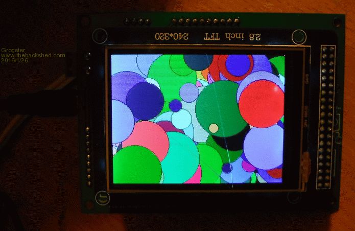

Posts: 12265
Posted: 10:43pm 25 Jan 2016
The only thing wrong with the above is the comments which weren't updated from the 44-pin version.
Corrected comments below - just tested on 5.1 64-pin MM+
Use the same pins on the 64-pin MM+ as you would for a SSD1963 display. Remember that you must connect to data pins DB8-DB15 on the display and not DB0-DB7
sub mm.startup
end sub

UPDATE: Solder-blob J3 is OPEN, which would seem to be correct, referring to the other thread....

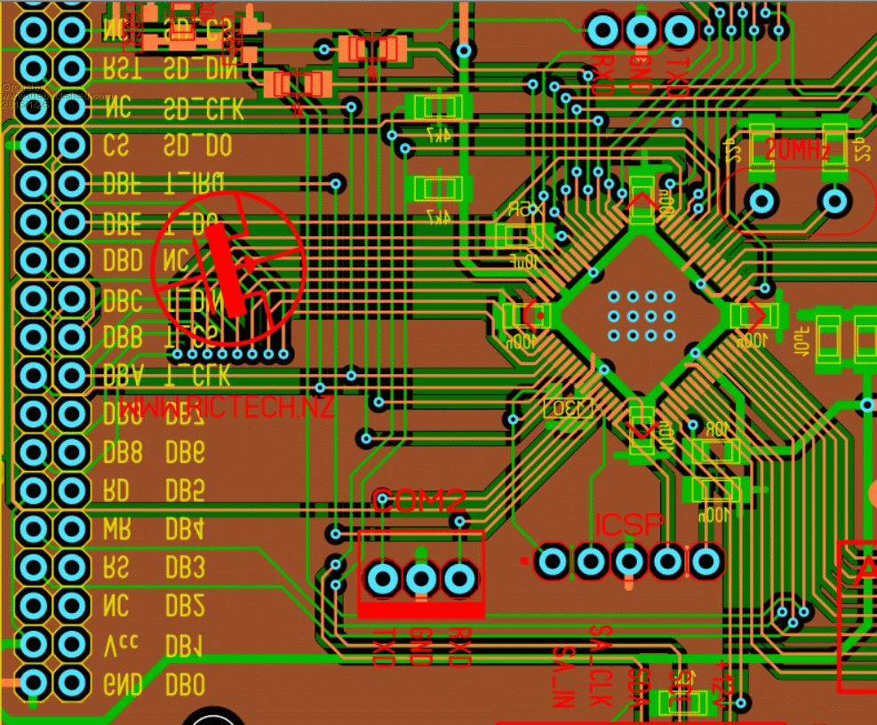

Here is an image of how I have the LCD connected to the 64 pin chip:
I've made the tracks brown on green to make them show up a little better then blue on green. I don't see any obvious mistakes here, but am double-checking this now.
The DB0-DB7 for the 1963 displays as per the MM+ advanced manual, are connected to DB8-DBF on the layout, which is correct 8-15.

  matherp said  I've also made J1 which bypasses the regulator as I run 3.3V supply.
Where is J1?
I only see a J3.
I too am running the display from 3v3, but the backlight from 5v.
EDIT: These are the LCD's I bought, and although the photo looks the same as your ones in the other thread, the ones sent to me are a different PCB:
Note this one uses a different PCB layout from the one in the actual eBay listing.
Do you think it is possible I have been sent the wrong ones?
EDIT: Looks like J3 on THIS LCD is the 3v3 regulator bypass, based on what my microscope is showing me. :
I will try bypassing this by SHORTING the J3 solder blobs. Problem is, if that bypasses the reg, there then is no way to put the display into 8-bit mode, so I might be in the market for more LCD's...
Edited by Grogster 2016-01-27

Posts: 12265
Posted: 11:58pm 25 Jan 2016
This display is your layout. Note it says that it can be converted to 8-bit operation but doesn't say how.
So it is the 16-bit databus that is definitely the issue. The problem is to find the fix.
Looking at the pics again R" may be the LED resistor (3.9ohm?) if so this won't help.

UPDATE: No change shorting out J3. I have a couple of these LCD's, so I am swapping each one to make sure I don't perhaps have a crook one. Time to get it out of the carrier...
EDIT: Just saw your post - yep, that's my trouble-child! I will take the LCD out of the carrier, and post a shot or two from the microscope. You might be able to see what I need to change - MIGHT be....

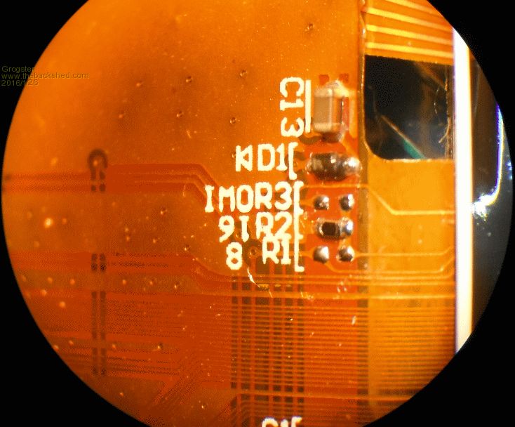

UPDATE:
Under the shell:
Does that give any insights?
I am thinking that perhaps R2("16"), needs to be removed, and a blob on R1("8")
Would you think this would be a good place to start?
I could TRY to move the black thing on R2, but it is TINY, and I think I would end up having some problems, even under the scope. I could make the attempt though - nothing ventured, nothing gained....
Posts: 12265
Posted: 12:25am 26 Jan 2016
I think you have found it.
Move the resistor that is on R2 to R1.

Here is a 30x close-up, but I note that the 'Resistor' is not marked with anything at all to say what the hell it actually is. Normally, resistors are marked. Oh well...
I will try to move it.
Posts: 12265
Posted: 12:34am 26 Jan 2016
I've found if you use the soldering iron in one hand and have a very fine screwdriver in the other, heat the resistor and it will stick to the soldering iron. Move it to the new location and then hold it down with the screwdriver then remove the soldering iron.
There is the same mod on the SSD1289 displays and the above approach worked easily for me
Posts: 2567
Posted: 12:51am 26 Jan 2016
sharp pointed stainless-steel tweezers. use a soldering iron bit that is wide enough to cover both ends of the resistor at once
0402 resistors generally have no markings.
rob :-)
Posts: 10147
Posted: 12:59am 26 Jan 2016
SUCCESS!!!
That 'Resistor' felt like an 0402 to me, maybe even 0201 - it was frickin' tiny. Only about a quarter the size of the 0805 on the other side of the board. Just a speck, and nothing more.
Managed to move it though - now all I have to do, is do the same move on my other ones to make them 8-bit.
