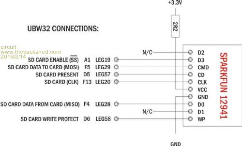

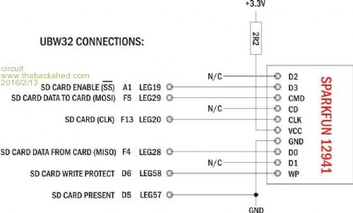

This afternoon I tried to apply the advice given; I regret that I am, once again, a little confused. I am using a UBW32 and this uses Colour MMBasic; not Micromite Basic. I can find no reference in Colour MMBasic 4.5 to OPTION SDCARD (I am familiar with this option when I use Micromite+ but does it apply to the UBW32 MMBasic?). The terminology used in the Micromite Plus manual seems to confuse me also; it defines the "CD-pin" as "card detect" whereas in the advice given by WhiteWizzard the connection advised is to connect CD to Card Select...
Right now, I think this to be correct, but I would ask that those with knowledge check it out for me before I commit the wiring.

Something further to add; I see some references to the D3 pin on the Sparkfun board being the CS or Chip Select input for the SPI interface. I am confused whether the A1 (leg19) SD Card Enable is an output or input; I am thinking it is the output to the SD card CS?

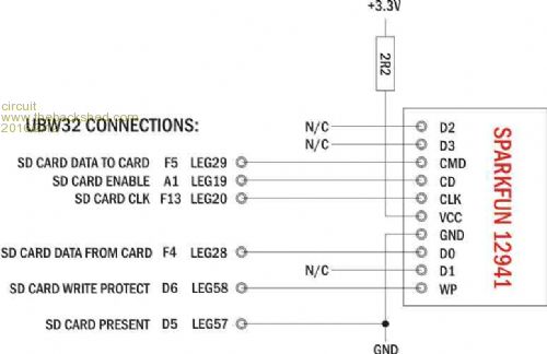

I have been searching around for information and now I have come to the conclusion that the CARD ENABLE line is the SPI chip select line and therefore should be connected to D3 on the Sparkfun board. Hence the revised schematic above.
Any help out there? I don't want to try it out in case I connect two outputs to each other or suchlike and blow an SD card.

Oh, dear! We seem to be going around in a full circle. The quoted schematic is, of course, amongst those that I am working from. I have purchased the SD Card connector that Geoff references in his UBW32 manual and the SD Card wiring is the same as the Maximite schematic, but the pin-outs on the recommended card do not correspond with the schematic - that is my problem. All that I want is to know precisely which UBW32 pins I connect to each of the terminals on the SD Card. I am presuming that SparkFun may perhaps have changed the card type since Geoff drew the schematic. For clarity, this is the SD Card Connector;
My latest thoughts are that the connections should be:
Can ANYBODY confirm or correct this, please? I note that Geoff's schematic is three years old and therefore are there any recommended modifications from experience or otherwise with regard to the installation of pull-ups as mentioned by Robert Rozee?

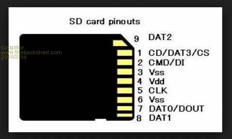

Your SD wiring needs to follow this graphic:
SD cards(all types) can be used in one of two modes: SPI(what we want), or 4-bit mode.
Pin1 of the SD card needs to go to pin38 of the CMM
Pin2 of the SD card needs to go to pin50 of the CMM
Pin3 of the SD card needs to go to ground.
Pin4 of the SD card needs to go to 3v3 via the 2R2 resistor.
Pin5 of the SD card needs to go to pin39 of the CMM.
Pin6 of the SD card needs to go to ground.
Pin7 of the SD card needs to go to pin49 of the CMM.
Pin8 of the SD card needs to be unconnected.
Pin9 of the SD card needs to be unconnected.
Card Detect(CD) on the SD card needs to go to pin82 of the CMM.
Write Protect(WP) on the SD card needs to got to pin83 of the CMM.
Those last two pins are optional, but if you plan to use them, you must connect them.
That should get you up and running.
It is important to note that the CMM does not allow you to pick and choose the PIC32 pins to use - they are set in the firmware, so you MUST use the pins in the list above, which I note that in your diagrams, you are not...
EDIT: I note you are referring to 'Legs' in your diagrams, which may well end up being the PIC32 pin numbers as above - I will have to check. Assuming it IS correct, then it should be working.

Grogster, thank you. Yes, my reference to "Leg" is to the arrangement of the connections on the periphery of the UBW32 board, not the PIC - and I have checked as far as I can and these do seem to correspond with the "CMM Pin numbers" that you quote. My problem lay, I think, in that there was no clear and obvious correspondence between the SD Card pin numbers and the arrangement of connections on the recommended SparkFun card. Now that I have (with everyone's kind help) brought myself up to speed with SD Card technology - which I have to admit complete ignorance of initially - I think that my final proposed diagram is, indeed, the correct interpretation. I will give it a go in hard wiring tomorrow.

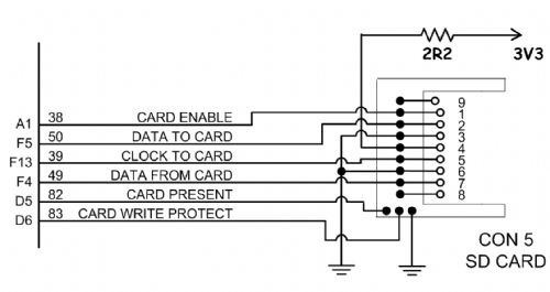

Posts: 2981
Posted: 05:33pm 14 Feb 2016
Hi Circuit,
Here is the relevant section of the Schematic for CMM.
For the purposes of testing, Pins PIC pins 82 and 83 (D5 & D6) can be grounded providing your SD card is present.
Use the SD card pin numbers Grogster provided in his very clear diagram above.
I would suggest using a multimeter to buzz out the SD adapter PCB to check the external pin connections to the SD card socket as they may not be directly aligned.
The left hand side of this diagram shows the PIC32 pin numbers and the pin names (names should reflect what the UBW32 interface pins are labelled)
EDIT***
Grogsters and my connection diagramss differ in the CARD ENABLE line (mine shows A1, Grogs shows A0) Try both but I think mine (A1) is correct.
