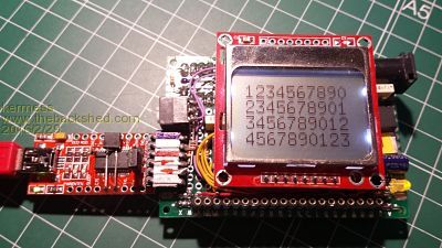

Hi.
I have installed on my breadboard the NOKIA 5110 with PIC32MX170 and I installed this program CFunction NOKIA5110loadable.bas I've tried in two different breadboard and the result is the same. The only difference is that I use in DCpin, RSTpin y CSpin these other pines 22,21 y 23.
Then describe in detail the implementation process.
CPU …. NEW and LIBRARY DELETE. … ok
LOAD the NOKIA5110loadable.bas … ok
CPU .. Power OFF and Power ON … ok
The Cfunction is ON … ok
I write in Command Line (TeraTherm) dirctly … TEXT X,Y,” Micromite”
POS 0,0 … 0,11 … 0,22 … 0,33
Display definition 4X10 with de Font definition by defect
So far everything is correct

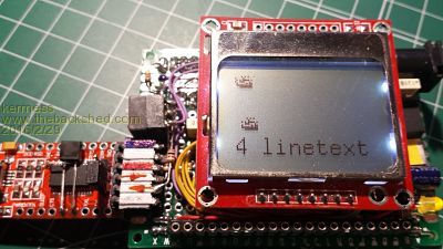

If I mount a program directly through the editor and RUN …
This is the result
This is the program.
'MODE TEXT in NOKIA5110 Display with this CFUNCTION
'NOKIA5110loadable.bas
Input "Text ",a$ 'manual pause
CLS
Text 0,0, "1 Linetext"
Text 0,11,"2 linetext"
Text 0,22,"3 linetext"
Text 0,33,"4 linetext"
CLS
If I stop in the program and manually type TEXT everything is correct.
QUESTION
what am I doing wrong ..??
Someone has happened .. ??
Possible solutions .. ??
Thank you.
A greeting.
David.

Posted: 11:33pm 28 Feb 2016
Hi David,
Out of interest, which version of MMBasic are you running (shown at the start-up message)?
Also, can you try commenting out all the lines in your DO..LOOP apart from the first two (TEXT 0,0.... and INPUT ....), and the last one (CLS). Then run your code and see if it prints the '1 Linetext' message on the screen

Hi WW …
Micromite version is "Micromite MKII MMBasic View 5.1"
If I run print MM.VER is "5.01"
The program only intend to evaluate the printing in screen Nokia 5110
Through each written line four there exists a pause.
My intention with this display is to present small written messages.
The graphic parts we do not interest me, although I have tried several circles and presents well.
David
Posts: 12265
Posted: 03:08am 29 Feb 2016
This is a bug introduced because of a change in 5.1. Unfortunately it is quite a difficult fix. Please hang on and I'll post updated code ASAP
Posts: 12265
Posted: 04:26am 29 Feb 2016
David
Please try this new version.

Hi,
Fill the text screen, 10X4 CHR$ are 20 milliseconds .....
Four lines 10 CHR$
Perfect, guai,
Thanks peter, .... Phil the same
Gracias a todos.
David

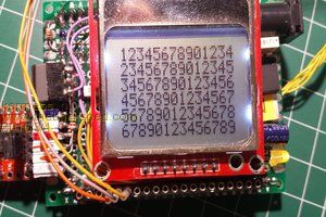

Hi Peter.
You can change the definition of text 10X4 chr to 14X6 chr .. ???
It is to get maximum data on this small screen.
If it is posible ....
Thank you.
David

Hi Peter.
I tried this program and the sources they have are perfect as they are in 14 chr X 6 lines.
2014-02-18_072256_Nokia5110Clock.zip
The drawback is that because so cfunction not be in the calling process to print text on screen is much slower.
Anyway thank you very much for your help.
I can work with the definition 10 chr X 4 lines
Un saludo.
David.Edited by kermess 2016-03-04

David
See new thread for loadable 8x6 font which will give 14 x 6 display.
Just include the font definition in your program and set it as the default
"FONT 8"Edited by matherp 2016-03-04

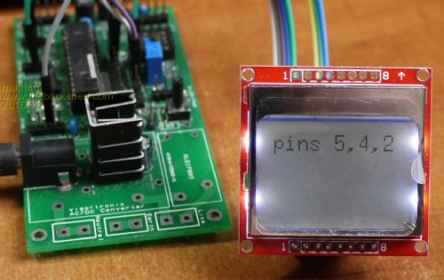

I have a project that uses a NOKIA5110 screen. I am using Jman's code but thought I would give this one a go. I loaded the code but can't get it to work, I read Embedded C Modules that comes with the Firmware distribution but having problems. How and when do I call the Csub and get text to the screen.
Paul.

  Quote  How and when do I call the Csub and get text to the screen.
Connect the normal SPI pins to the clock and data connections
Then edit the attached to use the correct pins for your application (DCpin, RSTpin, CSpin) and load it to the Micromite - and then reboot. The driver should report it is loaded when you reboot. You can then use all the normal graphics commands "TEXT", "BOX" etc. from the command line to test all is OK e.g.
TEXT 0,0,"Hello"
If all is well use "LIBRARY SAVE" then "NEW" and reboot again. The driver should report that it is loaded and you can then forget it and work on your application. It will automatically be loaded after every reboot until you do "LIBRARY DELETE"

I get an error Pin 4 reserved on Startup. I have used these pins
NOKIA5110(5,4,2,&HBb,1).

Posts: 12265
Posted: 11:17pm 06 Mar 2016
  Quote  I get an error Pin 4 reserved on Startup.
The load program can only be run once as it allocates the pins and then you get "reserved" errors
Start with a clean MM. LIBRARY DELETE, NEW, no OPTIONS (use the !!!!! to do this)
Then upload the driver and reboot - nothing else. At this point the driver will work if your pinout is correct. You never need to call anything again to do with the driver - just use the normal graphics routines
My pinout was for a 44-pin where pin 3 is not allocated to SPI but your pins should be fineEdited by matherp 2016-03-08
Posts: 3002
Posted: 11:19pm 06 Mar 2016
@palcal
To check which pins are in use, type OPTION LIST and see where/if Pin 4 is used.
Did you save as a LIBRARY (possibly with matherp's pins) but not yet delete it?? If so, it will be 'reserving' pin 4 and hence the message!
