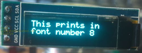

I should never have doubted Geoff's brilliance
His code works perfectly with fonts of any width.
Attached is a 8x6 font as in the original graphics drivers I wrote (7x5 symbols with one column to the right and one row below.
This is a much better font for the small displays than the default and takes almost no room in the program

Hi Peter
This font looks really nice on the small display (96x16)
Thanks for this.
These OLED displays have having an amazingly clear image
the photos do not do them justice
Jman

  Quote  but how do I use the Degree symbol
You can always access any character using CHR$(ascii-code)
so the degree symbol is CHR$(123). Note however that the symbol in the font I converted is some strange combination of the deg symbol and the letter "C". You can use Jim's font editor to change it if that doesn't suit
