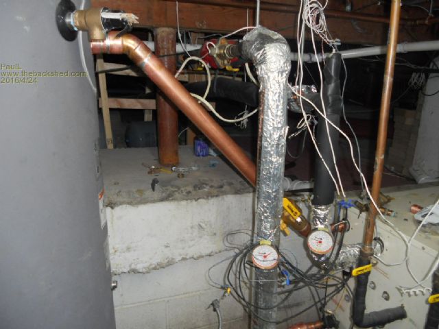

Paul_L
Joined: 03/03/2016
Posts: 769
Posted: 12:42am 09 Mar 2016
  CircuitGizmos said
Well you could gut a Model III and stuff it with Maximite + all of your other circuitry. Perhaps you could find an old unworking one.
I looked on Ebay and working Model III still go for $150-$300. Makes me sad that I tossed mine 20 years ago. I also tossed a Lear dumb terminal in great condition and working that ebay has for $500. Vintage.
Up in the attic I have three Model III's with 2 double sided floppies in each for a massive 1.5MB of disk storage! I also have a Model II with a separate drive bay for 4 each 8" floppies with an astounding 4MB of disk storage! The last time I checked they still worked!
Paul
Paul_L
Joined: 03/03/2016
Posts: 769
Posted: 01:30am 09 Mar 2016
The small LCD displays won't work for me. There are too many operating parameters to display.
I suspect that I would wind up with two Color MaxiMites talking to each other through some sort of Wi-Fi or Bluetooth RF link.
One MM would be buried in the wall of a laundry room directly above the heat pump in the basement. It might be connected to a wall mounted VGA display permanently to display what it is doing, but it probably would not have a keyboard permanently attached.
It would be reading 14 band gap temperature sensors and controlling the operation of the 84000 Btu/Hour Freon compressor, the two pumps for the outside loop, the one pump to the heat storage tank, and the seven pumps and one forced air blower on the distribution side, in a continuous loop. The Freon compressor and heat exchangers can get into trouble very quickly if maximum Freon pressures are exceeded or if the water freezes in the plate type heat exchangers.
The second MM would possibly be attached to the back of a VGA monitor which would be able to roam around the house. It would talk to the stationery MM by receiving and sending concatenated strings of about 40 operational variables and settings back and forth using some sort of RF link. It would continuously display what it is doing, accept user input to change the settings variables, and it would build a data file of historical minute by minute data which would either be downloadable to a PC or would be on a removable camera card which could be removed and copied to a PC quickly. The user input of changes to the settings variables would only need a numeric keypad.
It would be nice if I could use a small battery powered LCD screen but there just wouldn't be enough screen real estate to display what I would like. I'm afraid that the roaming unit will have to be supplied with AC power.
Battery operation of the monitors is not critical. If the utility power fails the water pumps and Freon compressor won't be running anyway. Extreme portability is not needed.
I have been trying to implement this thing using a picaxe to collect the data from the temperature sensors, a router running OpenWRT Linux and a Lua program retrieving the data from the picaxe via i2c, doing all the calculations, building an html web page, and sending the web page via a local RF network to a browser running on a laptop. I have run into the problem of continuously rebuilding the web page in the router and then getting the browser to repeatedly reload the webpage from the router.
The result has been a lagging display of operating data which is not what I want. I can't adjust the limit settings effectively enough because I can't see the temperature and pressure changes quickly enough.
The interpreted MMBasic running on a pic chip will be a lot slower than the Lua program running under Linux in the router, but there is not a lot of computational load involved and MMBasic should be quick enough to do the job.
I am reluctant to use derivative forks of the MaxiMite which have not been continuously developed in the past. I think that the Color MM is the only device which I can safely use.
I am not sure how I can implement the RF communication links. Updating data to the roaming unit doesn't have to be very frequent. One data burst per second would be sufficient. Transferring changes in the limit settings from the roaming MM to the stationary MM would only happen when the operator makes manual changes on screen.
Does anyone have any suggestions about the RF transmitter/receivers and the protocols that could be used???
More details will follow soon.
Paul
isochronic
Joined: 21/01/2012
Posts: 689
Posted: 11:58am 09 Mar 2016
I think Kon's module would be a good (and stylish) platform for this -
http://www.thebackshed.com/forum/forum_posts.asp?TID=8160&PN=4&TPN=2
Posts: 2528
Posted: 01:44am 10 Mar 2016
search for "HC-12" on the forums. a pair of these modules should provde suitable range for your application, with a transparent serial link presented between your two maximites.
here is a copy of the datasheet:
2016-01-14_122335_HC-12_v2.3B.pdf
have you got your band gap temperature sensors already installed? what temperature ranges need to be measured? i'd be quite interested in seeing photos of the whole installation.
rob :-)Edited by robert.rozee 2016-03-11
Paul_L
Joined: 03/03/2016
Posts: 769
Posted: 09:56pm 10 Apr 2016
  bigfix said
So you better go with matherp's recommendation for using the current 64Pin uMite+ with 7" SSD1963 based displays instead of sticking with a rather rare deadend version
BTW I also use a groundwater based heatpump since 30+ years in Austria
I also planned sophisticated control - but found it works perfectly with the most simple heating controller, only based on calculating the heating water temperature with the measured outdoor temperature - no inside sensor at all
But this is a high latency massive house - it takes many hours to change anything...
Guenter,
Thanks for your recommendations. I'm not surprised to hear that you are using a groundwater heat pump, there are a lot of such installations in Austria because the government supports them and because of the difficulty obtaining sufficient fuel oil and natural gas in Europe in general. I'm very familiar with your part of the world because I worked for Pan Am for a third of a century. What is the altitude where you live? My wife grew up south west of Klagenfurt on the slopes of Triglav in Slovenia.

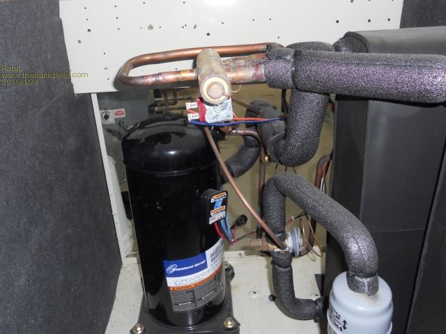

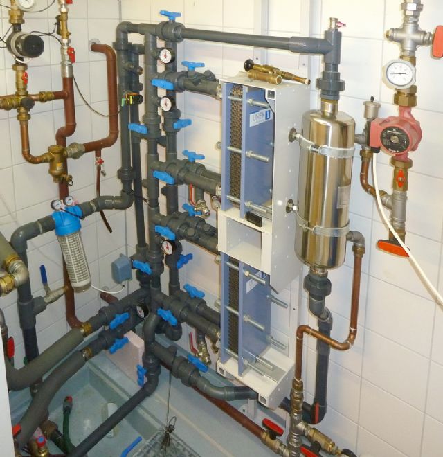

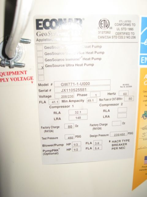

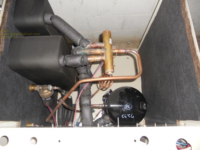

Using your simpler approach of controlling the heating water temperature based on the outside air temperature won't work for me. The Freon compressor I'm using is rather large for a residential installation. It draws 12000 watts running on a 240 volt line voltage with a running current of about 50 amperes and a locked rotor starting current of about 150 amperes. It is capable of pumping about 75000 Btu or 22 Kw of heat under good conditions.
Under less than optimum conditions it can, in a few seconds, develop either a low suction pressure or a high discharge pressure which will cause a protection circuit internal to the compressor to shut it down before it damages itself. After this shutdown you have to manually remove mains power from the system for five minutes to allow the Freon pressures to equalize, then reapply mains power and wait for 4 minutes until a time delay circuit restarts the compressor.
This safety shutdown does not trigger an alarm to let you know it has occurred, and it occurs most often in the early morning hours of very cold nights. After a few hours without pumping heat my Saint Bernard dog Brunhilda wakes me up because she is cold, so I get out of my warm bed, put on my slippers, walk 70 feet to the stairs, go down into the garage, pop the main breaker, stand there shivering for a few minutes, switch the breaker back on, stand there shivering for a few more minutes until the compressor starts, wait for it to stabilize with reasonable operating temperatures and pressures, go back to bed, spend a few minutes convincing Brunhilda to get off my bed and then try to go back to sleep.
That's why I can't use the simpler control methodology which works for you.
I intend to use band gap sensors to monitor the temperatures at these points:
1. the water being pumped to the ground heat exchanger,
2. the water returning from the ground heat exchanger,
3. the low pressure Freon entering the compressor,
4. the high pressure Freon leaving the compressor,
5. the water being pumped to the 120 gallon insulated heat storage tank,
6. the water returning from the storage tank.
The processor will perform the following steps in a loop:
1. read all the temperature sensors,
2. decide if a compressor shut down due to low or high Freon pressure is imminent,
3. decide if ice is about to form in the input and output plate type heat exchangers,
4. shut down the Freon compressor if necessary.
This shutdown will occur before the internal compressor shut down occurs. The program will then loop back and do it all again. It will restart the compressor as soon as the abnormal condition clears.
It is unfair to Brunhilda to keep waking her up in the middle of the night.

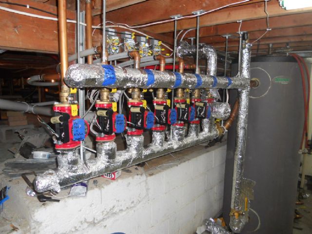

This processor will also handle other chores in its code loop including:
5. read inside air temperatures in 6 zones of the house,
6. control 6 distribution pumps,
7. calculate the optimum temperature of the storage tank based on outside air temperature,
8. cyle the Freon compressor and loop pumps to achieve the desired temperature,
9. calculate when to supplement the heat pump by burning natural gas under very cold conditions,
10. calculate when to switch from heating the house to cooling the house by reversing the Freon flow,
11. prepare a data file of all readings and operations for downloading to a PC for analysis and for transmission to a second processor which will handle data display and user input,
12. accept user input received from a second processor.
This house probably does not have as much mass as yours. It is a typical stick build American ranch house with good insulation. It does not have poured concrete or tile walls and roof. It therefore reacts much more quickly to heat flows than your house does. That's why I included the 120 gallon (450 liter, 960 pounds, 435 Kg) insulated heat storage tank. It averages out the temperature fluctuations produced by the cycling of the Freon heat pump.

Hi rob,
The HC-12 looks like it will do the job.
I have been using thermistor sensors and Dwyer temperature switches to control this mess for about 4 years. The sensors are tie wrapped to the outside of the pipes and then covered by insulation.
I haven't purchased the band gap sensors yet, but I don't anticipate any problem in getting them to respond quickly enough. The required sensing range is from -20°F to 120°F for the air sensors, 25°F to 160°F for the water sensors, and 15°F to 200°F for the Freon sensors. All the sensors will be used in the 12 bit mode thus delivering a resolution of 0.1°C or 0.18°F.
I would like to be able to measure the Freon pressures directly but I have not been able to find sensors that would be easy to apply and have the required pressure range.
I would be glad to provide photos of the installation but the web site doesn't seem to want me to. When I press the image upload button above it uploads the photo file which then seems to drop into the bit bucket.
Paul
