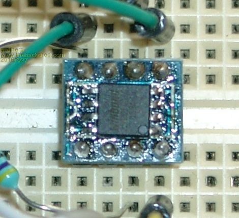

This one I'm pleased with
Since playing with the ESP8266 I've been interested in exploring how Serial Flash memory chips could be used for secure data logging on the Micromite as an alternative to SDcards or an external device like an Openlog.
These chips are ridiculously cheap so there is no reason not to include one on every PCB. Winbond branded chips work perfectly with the program and are recommended.
The example shown above is the one I used to develop the code and will hold 4Mbytes. Compatible chips are available from 512kbyte to 16Mbytes and the code should automatically cater for any of them.
Connections to the 8-pin chips are simple:
pin 1 (chip select) - connect to any Micromite output capable pin
pin 2 (Data out) - connect to the SPI-IN pin on the Micromite
pin 3 (write protect) - 10K resistor to 3.3V
pin 4 (GND) - connect to ground
pin 5 (Data in) - connect to the SPI-OUT pin on the Micromite
pin 6 (Clock) - connect to the SPI-CLK pin on the Micromite
pin 7 (Hold) - 10K resistor to 3.3V
pin 8 (VCC) - connect to 3.3V
The chips are a wide version of SOIC and can be easily soldered to a DIP adapter. This could then be socketed on the PCB allowing it to be swapped for reading separately in the same way as an SD card.
The intention of the coding was to hide all the workings of the chip from the user and make the user interface as simple as possible so there are just three user routines:
formatlog(chip_select_pin_number)
This routine completely erases the chip and tests it for correct erasure. In the event that the erase fails the routine will print a message and the program will end. The routine prints the ID of the chip and the size in Mbytes. It also writes to the chip an index of used pages that the logging routine uses to determine where a new record should be appended.
writelog(string-to-write, chip_select_pin_number, timestamp)
This routine appends the supplied string to the log. If the variable "timestamp" is non-zero it will automatically prepend the date and time comma-separated to the front of the string. If timestamp is 0 or not specified the string will be written as supplied. Logging strings can be constructed in the normal way using STR$ to format numbers and the "+" operator to concatenate multiple sub-strings.
readlog(chip_select_pin_number)
This routine reads the complete log and prints the contents to the console. To upload to a PC just set Teraterm (or equivalent) to record the terminal session and call readlog. The routine does not change the log data in any way so logging can be restarted after reading without any impact.
NB all of the routines are completely self-contained and can be called from the command line with no requirement for anything to have been run or set up previously - there are no global variables or constants - everything required to run is stored on the chip itself. They also obey the requirements for sharing the SPI bus with a TFT screen on the Micromite.
This means calls to the formatlog and readlog routines need never be included in the running program as they can just be called from the command line as and when required.
It really can't get any easier to include logging in any Micromite program.
The test program attached demonstrates just how easy it is to including logging commands in a program. I've tested the code using 1000, 10000, and 100000 log records. It takes 183 seconds to construct and log 10000 records.
The C-source is attached, there is nothing complicated and it was all written first in Basic and then just converted to C for improved performance.

00001821
End CFunction
' test data generation
'small
sub testdata
DATA "one", "two", "three", "four", "five", "six", "seven", "eight", "nine", "ten"
DATA "eleven", "twelve", "thirteen", "fourteen", "fifteen", "sixteen", "seventeen", "eighteen", "nineteen"
'tens
DATA "twenty", "thirty", "forty", "fifty", "sixty", "seventy", "eighty", "ninety"
'big
DATA "thousand", "million", "billion"
dim small(19) AS STRING length 10, tens(7) AS STRING length 10, big(2) AS STRING length 10
FOR i = 1 TO 19
READ small(i)
NEXT
FOR i = 0 TO 7
READ tens(i)
NEXT
FOR i = 0 TO 2
READ big(i)
NEXT
end sub
FUNCTION int2Text(number AS integer) as string
local num AS integer, outP AS STRING length 60, unit AS INTEGER
local tmpLng1 AS integer
IF 0 = number THEN
int2Text = "zero"
EXIT FUNCTION
END IF
num = ABS(number)
DO
tmpLng1 = num MOD 100
SELECT CASE tmpLng1
CASE 1 TO 19
outP = small(tmpLng1) + " " + outP
CASE 20 TO 99
SELECT CASE tmpLng1 MOD 10
CASE 0
outP = tens((tmpLng1 \ 10) - 2) + " " + outP
CASE ELSE
outP = tens((tmpLng1 \ 10) - 2) + "-" + small(tmpLng1 MOD 10) + " " + outP
END SELECT
END SELECT
tmpLng1 = (num MOD 1000) \ 100
IF tmpLng1 THEN
outP = small(tmpLng1) + " hundred " + outP
END IF
num = num \ 1000
IF num < 1 THEN EXIT DO
tmpLng1 = num MOD 1000
IF tmpLng1 THEN outP = big(unit) + " " + outP
unit = unit + 1
LOOP
IF number < 0 THEN outP = "negative " + outP
Do WHILE ASC(RIGHT$(outp,1))<=32
outp = LEFT$(outp,len(outp)-1)
loop
int2Text = outP
END FUNCTION
#define writeenable 0x06
#define pageprogram 0x02
#define readstatus1 0x05
#define readdata 0x03
#define eraseall 0xC7
#define JEDEC 0x9F
#define SPIsend(a) {int j;SPIBUF=a; while((SPISTAT & 0x80)==0); j=SPIBUF;}
#define SPIread(a) {SPIBUF=a; while((SPISTAT & 0x80)==0); a=SPIBUF;}
#define SPISTAT *(volatile unsigned int *)(0xbf805810)
#define SPIBUF *(volatile unsigned int *)(0xbf805820)
long long pagecount(char id[],long long *cspin){
int pin=*cspin,i,j,k;
if(ExtCurrentConfig[pin]!=EXT_DIG_OUT)ExtCfg(pin,EXT_DIG_OUT,0);
PinSetBit(pin,LATCLR);
SPIsend(JEDEC);
SPIread(i);
SPIread(j);
SPIread(k);
PinSetBit(pin,LATSET);
IntToStr(&id[1],i*65536+j*256+k,16);
id[0]=6;
return (1<<(k-8));
int erasechip(long long *size, long long *cspin){
int p,pin=*cspin;
char m;
SPIsend(writeenable);
SPIsend(eraseall);
do {
uSec(50000);
SPIsend(readstatus1)
SPIread(m);
} while(m & 1);
SPIsend(readdata);
SPIsend(0);
SPIsend(0);
SPIsend(0); //start address is zero
for(p=0;p<*size;p++){
SPIread(m);
if(m!=0xFF){
return 0;
return 1;
void writepage(long long *address, char d[], long long *cspin){
int k=0,add,m,pin=*cspin;
add=*address<<8; //convert page number to byte number
SPIsend(pageprogram);
SPIsend((add>>16) & 0xFF);
SPIsend((add>>8) & 0xFF);
SPIsend(add & 0xFF);
for(m=0;m<256;m++) {
SPIsend(d[k]);
k++;
do {
uSec(250);
SPIread(m);
} while(m & 1);
void readpage(long long *address, char d[], long long *cspin){
int k,add,pin=*cspin;
char m;
SPIsend(readdata);
for(k=0;k<256;k++){
SPIread(m);
d[k]=m;
long long getfirstfreebyte(unsigned char d[]){
int j=0;
if(d[0]==0xFF) return 0;
for(j=1;j<256;j++){
if(d[j]==0xFF) return j;
return 256;
long long loadstring(unsigned char s[],unsigned char b1[],long long *pos){
int k,j=0,len=s[0],start=*pos;
for(k=start;k<=start+len;k++){
b1[k]=s[j];
j++;
return start+len;
long long getstring(unsigned char s[],unsigned char b1[],long long *pos){
int k,j=0,start=*pos,len=b1[start];
s[j]=b1[k];
j++;
*pos=start+len+1; //start of next string
return b1[start+len+1];
Edited by matherp 2016-03-28

Posts: 11882
Posted: 03:20am 27 Mar 2016
  Quote  with this addition, a flash chip could be used to hold data that an mmbasic program could itself make use of.
Rob you already have everything needed to do something like this in the current code:
the function "writepage" writes a block of data to a specific page on the chip
writepage(page_number, data, chip_select_pin)
because of the way variable passing to CFunctions works "data" can be anything that adds up to 256 bytes
dim string mystring$ length 255 '1 byte length + 255 bytes of data
dim float myfloats!(63) ' 64 x 4-bytes
DIM integer myintegers%(31) '32 x 8-bytes
Likewise "readpage" can do the same thing
readpage(page_number, mystring$, chip_select_pin)
readpage(page_number, myfloat!(), chip_select_pin)
readpage(page_number, myintegers%(), chip_select_pin)
I specifically wanted to make the logging commands context free i.e. the Basic program shouldn't have to remember anything in order to use them. However, using the primitives as above you can use the flash chip for anything. If you want to use logging in addition then it is probably best to do direct access to high pages in the flash memory and then logging will continue to work from the beginning of flash. It would then be up to the Basic program to know what was in each page used in this way. Effectively readpage and writepage allow direct access to any 256-byte record. The log data can't be treated in this way as it is effectively a sequential stream so to access the 100th string you have to read the first 99 first.
readpage and writepage would just need wrapping with SPI OPEN and SPI CLOSE commands and if used by themselves the user would need to ensure chip_select_pin was set as an ouput (this is done at the moment in C by the "pagecount" comand)
Posts: 11882
Posted: 03:25am 27 Mar 2016
Do Serial Flash Memories not have page boundaries to worry about like EEPROM?
Yes pages for writing are on 256-byte boundaries. My code takes care of all this for you without wasting any space.
The 4K "page" is the minimum that can be erased but I only use full chip erase.
Flash memory is erased to all "1s". Writes convert the relevant 1s to 0s. So I can write the same data to a page with no effect or I can write additional data to a page that is part written by reading what was there, updating with the new data and then re-writing.

Posts: 11882
Posted: 06:36am 27 Mar 2016
UPDATE
I should have mentioned in the original post that the spare pad on the back of many TFT displays will take one of the 25Q series chips and, at least on the displays I've checked, is correctly wired. The only additional connection is to the F_CS chip select pin on the display.
To improve logging speed by a factor of 2 please substitute this CFunction
CFunction getnextfreepage
00000000
27BDFEC8 AFB7012C AFBF0134 AFBE0130 AFB60128 AFB50124 AFB40120 AFB3011C
AFB20118 AFB10114 AFB00110 8C820004 8C830000 000227C3 308407FF 00831821
0064B82B 02E2B821 0017BD40 00031AC2 02E3B825 1AE00049 8CB60000 0000A021
3C159D00 3C10BF80 241E0003 27B20110 24130020 8EA2001C 02C02021 0040F809
24050005 00141A00 AE1E5820 8E025810 30420080 1040FFFD 7C623C00 8E045820
AE025820 8E025810 30420080 1040FFFD 7C623A00 8E045820 AE025820 8E025810
30420080 1040FFFD 00000000 306300FF 8E025820 AE035820 8E025810 30420080
1040FFFD 00000000 8E025820 27A30010 AE115820 8E025810 30420080 1040FFFD
00000000 8E115820 7C118C20 A0710000 24630001 1472FFF6 02C02021 8EA2001C
0040F809 24050006 8FA20010 8FA30014 00431025 14400013 00002021 27A20018
24040001 8C430000 8C450004 00651825 1460000C 24420008 24840001 5493FFFA
8C430000 26940001 0297102A 5440FFC2 8EA2001C 10000003 24040100 0000A021
00002021 27A30010 000410C0 00621021 8C460000 8C450004 30C30001 14600011
00001021 24020001 00055840 240A0040 00024827 00461806 012B4804 30480020
00453807 01231825 00E8180B 30630001 54600005 0014A140 24420001 144AFFF5
00024827 0014A140 02842021 8FBF0134 00042180 00441021 00021FC3 8FBE0130
8FB7012C 8FB60128 8FB50124 8FB40120 8FB3011C 8FB20118 8FB10114 8FB00110
03E00008 27BD0138

Hello,
Why not use the Microchip SST26VF032B flash? I try: JEDEC code, size ok,
write ok , but read back is nothing.
drkl
Posts: 11882
Posted: 11:43am 27 Mar 2016
  Quote  Why not use the Microchip SST26VF032B flash? I try: JEDEC code, size ok,
One problem is that the JEDEC ID doesn't give the flash size in the same format as Winbond. For Winbond the last part of the ID specifies the size as 2^ID2 bytes so for ID &HEF4016 &H16=4Mbyte, EF4017 = 8Mb, EF4014=1Mb etc.
The software uses this to set the size of the index.
The Microchip part sets the "size " as &H42. 2^&H42 means that the whole flash is dedicated to the index and nothing can be written.
To cater for this the full Microchip ID would have to be hardcoded in the pagecount CFunction then it might work if there is nothing else incompatible.
UPDATE
drkl
Please could you substitute this version of the CFunction in the code and see if it works with the Microchip flash
CFunction pagecount
00000000
27BDFFC8 AFB20024 AFBF0034 AFB50030 AFB4002C AFB30028 AFB10020 AFB0001C
8CB00000 3C029D00 8C420088 00101880 00621021 8C420000 24030008 10430007
00809021 3C029D00 8C420010 02002021 24050008 0040F809 00003021 3C029D00
8C42001C 02002021 0040F809 24050005 2403009F 3C02BF80 AC435820 3C03BF80
8C625810 30420080 1040FFFD 3C02BF80 8C435820 3C03BF80 AC405820 8C625810
30420080 1040FFFD 3C02BF80 8C545820 3C03BF80 AC405820 8C625810 30420080
1040FFFD 3C02BF80 8C555820 3C03BF80 AC405820 8C625810 30420080 1040FFFD
3C119D00 8E22001C 02002021 24050006 3C03BF80 8C735820 0040F809 00148200
24020010 AFA20010 02158021 8E220030 00108200 02138021 26440001 02003021
0040F809 00103FC3 24020006 A2420000 3C0200BF 24422642 24044000 1202000B
00002821 3C0200BF 24422602 12020006 2673FFF8 24020001 02629804 02602021
10000002 00132FC3 00002821 8FBF0034 00801021 00A01821 8FB50030 8FB4002C
8FB30028 8FB20024 8FB10020 8FB0001C 03E00008 27BD0038
End CFunction
Edited by matherp 2016-03-29
