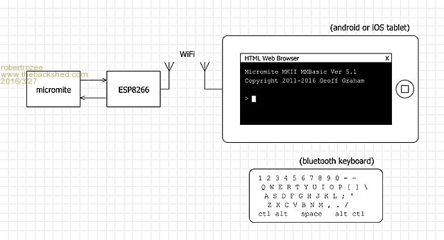

it is pretty neat, but not quite what i have in mind - the crome plugin essentially turns chrome into a teraterm workalike, with the connection to the target via a wired serial port (according to the demo video).
perhap this diagram better shows what i have in mind:
rob :-)
Posts: 4335
Posted: 05:52am 27 Mar 2016
That's what I thought you meant but it does seem extraordinarily painful to "want" VT100 between the left 2 items (umite & esp).

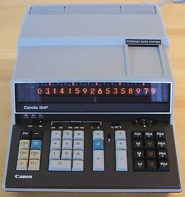

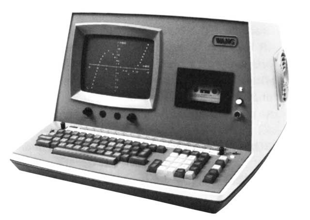

But late 70's brain cells have survived & still recall the hardware of addiction back then:....
The "Canola" with it's punch cards, and the Nixie tube displays.
And the REAL thing, the Wang, with lots of peripherals,
Cheers.
