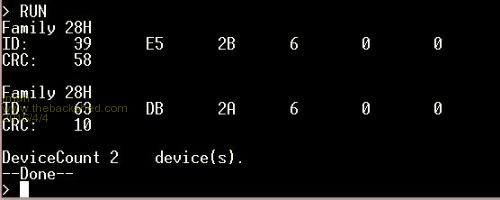

Have run this and your other routine on my single sensor & noticed a slight issue in the MMChat terminal in ASCII mode.
The tab characters seem to be suppressed between each Octet, and of particular relevance is the loss of the leading zero on the last octet.
All ok on a VT100 terminal.
No issues with the code at all.
Run
Family 28H
CRC:6F
DeviceCount 1 device(s).
--Done--
Run
Family 28H
ID: FF A6 67 A8 15 1
CRC: 6F
--Done--
Only a display issue in ASCII mode but did throw me for a few seconds.

MMEdit doesn't process the tab character. Maybe one day...
Re the leading zeros:
Replace all Hex$(ROM_NO(x)) with Hex$(ROM_NO(x),2) on lines 45-47
The leading character option for HEX$ is a recent addition to MMBasic. It saves a lot of work.
