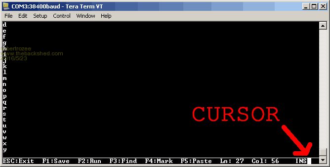

Posts: 2428
Posted: 12:50am 23 May 2016
try this:
with 26 lines in the editor, each one containing a single letter of the alphabet,
position the cursor over the last letter (not to the right of it, but over the character - with the cursor sitting in the first column of the terminal). now press the up arrow key to run the cursor up to the top of the listing. the cursor will stop over 'a'. now press the down arrow key to scroll down to the end of the listing.
on my setup, the cursor ends up at the end of the status line. same on teraterm and hyperterm.
rob :-)Edited by robert.rozee 2016-05-24
Posts: 3281
Posted: 06:41am 23 May 2016
These have to take the record for obscure bugs
The first one from panky and rob (a list of numbers) only caused trouble because zero was one of the numbers.
The second from Rob (empty line with a line number of 32) would only cause trouble if the line number was one of a special sequence (32, 306, 562, etc) and the line was otherwise empty.
The third (cursor at the end of the status line) would only cause trouble if you started by editing a completely empty program and the resultant number of lines was greater than the screen height and you had gone back to the beginning at some point.
Thanks guys for the detailed description, it made it much easier to track them down. How you found them I don't know but they will be fixed in the next release.
