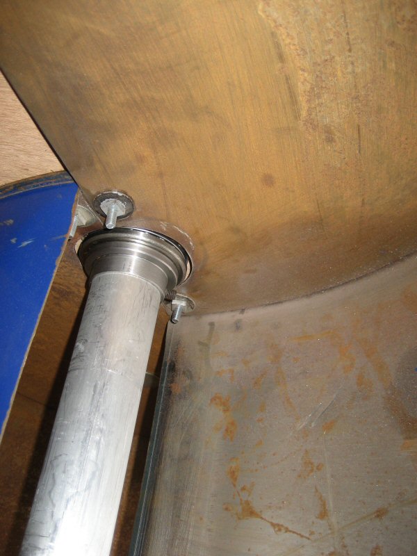

I have recently joined this excellent group and have been assembling a basic guyed Oil drum 2 stage Savonius VAWT using a LG Smartdrive generator.
I'm now at the testing and tweaking stage with the whole assembly rigged up in my workshop and me or wife spinning it by hand ;) At this time we are at the amazing and satisfying lighting a bulb when spun phase
I'm using two standard 50 gallon drums with a central shaft. I'm using an ex LG washing machine smartdrive motor in standard 3 phase star config to try and get some output at low rpm. I have not done any de-cogging as yet.
I using a standard 3 phase bridge rectifier made out of normal diodes at present, I have some Schottky ones on order. I am on the look out for unpolarised 100v 100uf caps to try that mod as well, once I have it up and running I may rewire stator depending on results.
I haven't decided on a final system voltage yet, I'll wait until I get some power results and then decide as I have a fairly flexible battery system in mind. Sadly I live in a very sheltered and turbulent wind area, I already have a normal Air-X type turbine which really struggles to stay into the wind.
Here are a few pics, I'll post more when it's up.

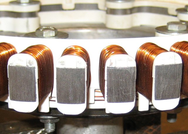

I have now decogged my LG UK Directdrive 36 pole stator prior to erection of my Savonius unit. Before decogging stator had very sharp edges to protruding coil lamminations, now rounded off quite nicely with a powerfile bought specially for the job ;)

A bit late to be checking this now I suppose, but with 36 poles did you check to see if the rotor magnets are rectangular or arrowhead? There seems to be a large gap between poles and this suits the decogged magnets.
To check, sprinkle some iron filings onto a magnet inlay. The iron filings will be attracted to the boundries between North and South. If they are angled or arrowhead ..... well too bad, if square to the edge then decogging well worthwile.
Cheers Gill _Cairns, FNQ
retepsnikrep
Joined: 31/12/2007
Posts: 134
Posted: 07:11am 03 Feb 2008
From the bits of swarf etc that collected whilst I was messing about with this I could see the magnets appeared to be rectangular.

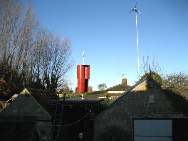

Posted: 01:47pm 03 Feb 2008
Up and running. Generating fairly easy 12v at 1 amp in low turbulent wind. Now charging a 12v battery.
Poor pic as light very bad today.
My weather station mounted on top.
Whole set up is about 12ft off ground on a flat car port type roof between two buildings. Sadly I just don't have anywhere else to mount it :(
Youtube video showing it going round in light wind. Edited by retepsnikrep 2008-02-05

My VAWT unit makes virtually no noise, and is much quieter than my HAWT Air-X 400W on the adjacent mast.
It also starts up in very little wind.
Savonius in better light
Savonius and Air-X
