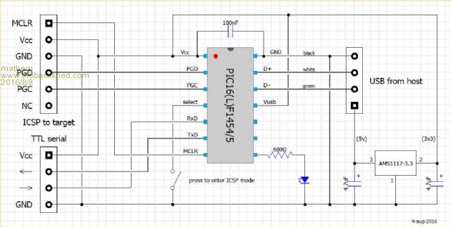

The PIC16F1455 provides one of the cheapest USB/UART connections for the Micromite and also, combined with PIC32prog, can be used to update the firmware in the Micromite. Previously MicroBlock has made available hex files to do this but has been unable to release the source as his code was built using the Microchip USB stack which is not open source.
The attached code is built on the m-stack USB stack which is open source so I am able to release the complete MPLabX project as well as the hex file to program the PIC16F1455. The hex should also work on the PIC16F1454, the PIC16LF1455 and the PIC16LF1454. It is intended that this code will also be uploaded to the PIC32prog github site.
2016-08-08_090654_usb-uart-prog.zip
The code as configured is completely compatible with BigMick's MuP ver. 3 and also my Ultimate Backpack available from CircuitGizmos. The hex file for the 16F1455 is in the usb-uart-prog directory and is named PIC16F1455V1.03.hex.
You don't need one of these boards though as the chip can easily be breadboarded. The attached circuit was prepared by Robert Rozee, the author of the ascii implementation of PIC32prog who has also provided much help during the development of the code.
Thanks are also due to BigMick and CircuitGizmos for helping to test the code.
You can program up the PIC16F1455 using a PicKit3. Alternatively ready programmed versions will be available from BigMick, CircuitGizmos and possibly others

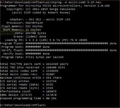

To program a PIC32 chip connect up the ICSP connections as in the diagram and briefly short pin 4 to ground (the switch in the circuit diagram). The LED will light showing the chip is now in programming mode. Make sure you have the latest version of the Pic32prog software from here.
Open a command window and use the command line:
pic32prog -d ascii:comxxx nnnn.hex
where comxxx is the com port that has appeared when the USB cable was connected and nnnn.hex is the firmware you wish to program into the PIC32.
The attached show a typical programming session:
Once the PIC32 is programmed the PIC16F1455 software will automatically revert to USB/UART mode and the LED will go out.
To reconnect just run a terminal emulator such as Teraterm or MMEdit and press return. The MM copyright banner will be displayed - no need to reset or reconnect anything.

Looking at your screenshot, that appears to be faster then the Arduino version too - is that my imagination?

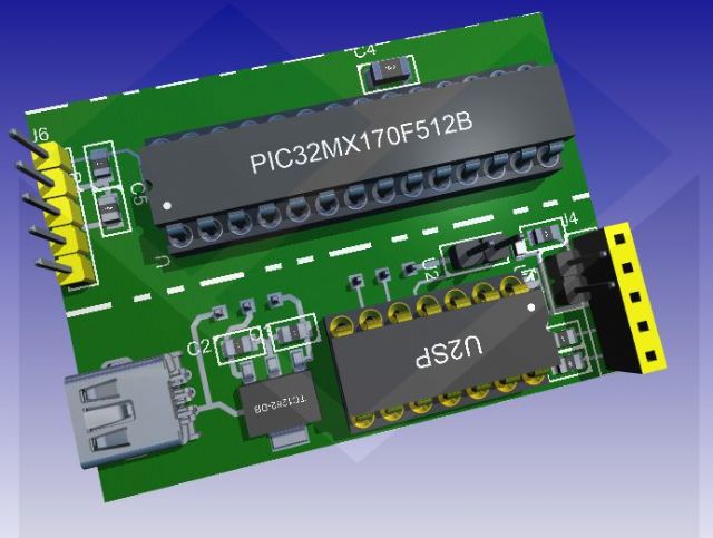

Posts: 2209
Posted: 01:56am 09 Aug 2016

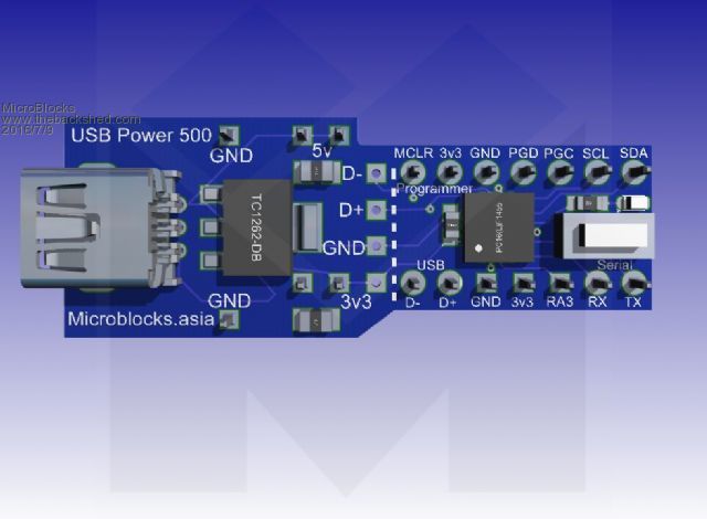

They have been send to the pcb manufacturer (slightly different as above picture as it has through hole caps and resistors and a TSSOP package for the chip that makes handsoldering easier. I expect them to arrive in about 10 days.
The price will be $3US for the bare pcb and $9.95US for a kit including all the parts (also preprogrammed chip).
They will probably also be for sale through Dontronics/Mick to have faster shipping.
From Thailand it is not more expensive (about $2US) but it takes anywhere between 10-28 days to arrive.
I also have another board that will arrive in the same time that is more like a programmer and an adapter board for 28 pin DIP.
They will be $5US for the bare PCB(both pcb parts)and $11.95US for a complete kit.
It is the same pinout as the 'Free' version by Matherp. If you already have a pickit 3 then you can use that version also. A kit is then 2US$ cheaper as you will then get an empty chip you need to program yourself.Edited by MicroBlocks 2016-08-10

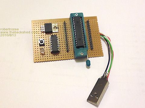

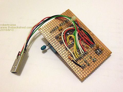

Posts: 2556
Posted: 05:12am 13 Aug 2016

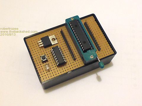

below are pictures of a built-up unit using peter's .hex file. programming an MX170 under XP is marginally quicker than using the original arduino NANO design (1m 43s versus a tad over 2 minutes), and the serial interface side of things works fine. the 1455 was recognized without any intervention, as some time ago i had loaded up the microchip .inf file containing their vid/pid pairs. i believe that under windows 7 and later this is built in.
one major advantage offered over a regular usb-to-serial bridge is that under teraterm one can now press alt-B to reset the micromite, no need for a separate reset switch.
someone may wish to take the form-factor i have used and turn it into a PCB for folks to purchase (fabrication cost would be about USD 0.60). the board is sized to fit in place of the lid of a small jiffy box, 79mm x 50mm. if laid out more compactly a mini-USB socket could be placed on the board to the right of the micromite, this makes a nice fully self-contained experimenters setup.
rob :-)
Edited by robert.rozee 2016-08-14

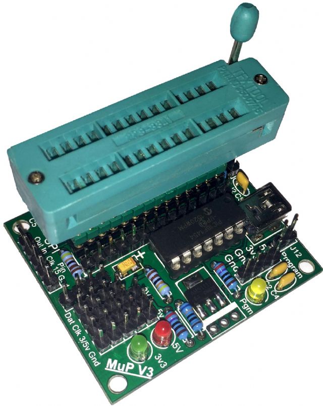

Posts: 2984
Posted: 02:54pm 13 Aug 2016
Hi All,
Of course a board similar to Robert's vero one does already exist..

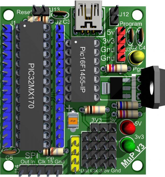

My MuP3 - Full details located here
It is smaller than the above Vero unit at 49.5mm x 43mm (1.95" x 1.69")
It supports either MicroBlock's U2SP-DIP chip or Peter and Robert's Free ware chip.. I can supply either if you can't burn your own.
Kind Regards,
Posts: 2556
Posted: 04:18pm 13 Aug 2016
good point, i forgot the MuP3. although, having a ZIF socket and a jiffy box protecting the back of the board can be useful.

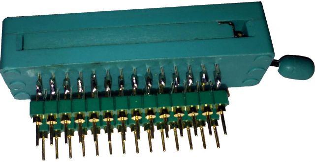

incidentally, i've found that the cheap ZIF sockets found on ebay (from china) can be very hard to get to solder nicely. extra flux and a hot iron were required in the end.
rob :-)
Posts: 2984
Posted: 05:49pm 13 Aug 2016
Rob, All,
As the pins of the ZIF sockets are too wide to plug into a normal socket, I have extended mine, using double ended round pins, like this.
Here is a shot of it plugged into a MuP3 ready to go.
As to protecting the bottom of the board, all you need there are rubber bumpers/feet added to the underside of MuP3.
Kind Regards,
