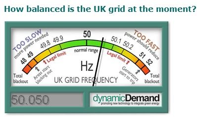

Hi Herry. This is a subject close to my heart - been tinkering with mains frequency measurement etc on and off over the last few years. Here in the UK, you are right there is a licensing agreement that the freq must stay within a tiny percentage of tolerance and the national grid provides this nice tool so you can see how they are doing. http://www2.nationalgrid.com/uk/services/balancing-services/frequency-response/ Years ago, the Post Office used to have clocks that worked using the mains frequency - which probably determined the legal aspect of mains control. I have a nice ZCD circuit which I was playing with earlier this month purely as an exercise to see how small I could make it and you get a pulse reliably around 2V either side of zero. It could stand a lot of improvements (Schmitt triggering etc... - or feed it in a Schmitt input of your PIC even better). Maybe it will give you some ideas. http://www.fruitoftheshed.com/Circuit%20Ideas.Really-Simple-Zero-Crossing-Detect.ashx On the subject of really accurate frequency measurement, have a look at Roman Black's site - he has done a lot with some really novel code to produce very accurate measurement/frequencies from any crystal... he even shows how to make a cystal oven for less that a buck(!) for hyper-stable crystal frequencies (I suspect this will figure in your design). HTH h |

Because of daily time correction measures done by all the civilized world's power grids, this long term 1 second accuracy you noted is entirely irrelevant to the short term accuracy of the power frequency. Short term being periods less than several hours. The short term accuracy of the power grid is terrible. See this website for a realtime presentation of the UK's National Grid (company name) system's accuracy for the last 60 minutes revealing departures of approximately .2 Hz over that time span (at the time of this writing). http://www2.nationalgrid.com/uk/Industry-information/electricity-transmission-operational-data/ So, the Micromite's crystal oscillator is certainly easily stable enough to show deviations of that magnitude. There is no way in the short term to calibrate the MM frequency by the power line with any certainty! For more fascinating information about power generation systems see the Wikipedia entry "Utility Frequency," especially the Stability section: http://en.wikipedia.org/wiki/Utility_frequency The University of Tennessee Power Information Technology Laboratory also has real time maps updated every few seconds; one for the US grids and one for the entire world: http://fnetpublic.utk.edu/ |
