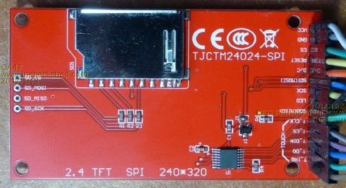

I am thinking of a project using MMBasic 5.2 ,MX470 chip and touchscreen where I would like to operate on dry battery. Would it be possible or satisfactory to turn on the unit by touching the touchscreen? Obviously I could have a drawbutton as the Off key and I was thinking of putting the MM to sleep say for 2 seconds and waking up for a couple of milliseconds to test for a touch to the screen.
Any thoughts would be appreciated.

Thanks Jim for pointing that out, I wasn't thinking enough. I like the thought of using the wakeup pin for touch. I will have a couple of free output pins available and could possibly use them to control backlight and LCD power but that still leaves the problem of configuring the LCD after the program has started.

  Quote  IF you can get to the 4 touch wires (the ones going from the display to the touch controller) you can use a touch to switch a transistor.
These connections seem to be at the back of the display between the PCB and the display but they may be accessible at the vias to the left of the touch chip XPT2046 on pins 3,4 and 5.

The touch wires don't look easy to get at with the 2.4 panels.
BUT:
Geoff has given you a late Christmas present with the beta10 firmware.
  Quote  Implemented the GUI RESET LCDPANEL command. This will reinitialise the LCD panel
and is useful if the panel had been previously powered down to conserve power.
This 'should' mean that you can power the LCD controller chip down and recover OK when you wake up.
To use the touch to wake up, you will have to disconnect it's power pin from the LCD panel regulator and supply it separately.
The regulator is above the XPT2046 in your photo and (if I am correct), you need to cut the trace under the 'C1' text.
Either that or cut the trace where it goes to the main controller (after C1) and supply the controller with a new regulator.
I don't have a circuit diagram and haven't looked at the other side of the circuit board so there is some guesswork here.

Joined: 08/08/2017
Location: Mexico
Posts: 26
Posted: 06:26pm 25 Sep 2017
