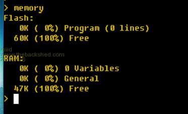

Is the memory available decreased (ie because of the usb stack) ?
kiiid
Joined: 11/05/2013
Posts: 671
Posted: 08:15pm 05 Apr 2017
