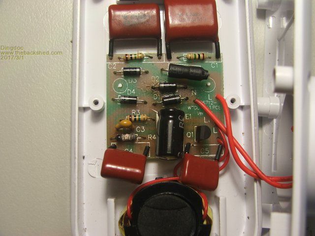

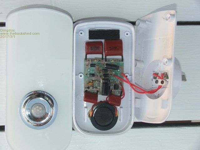

Recently I was asked to see if I could fix a 'Click' nightlight/torch unit which had stopped working. It has an inductive mains charger cradle which holds the light unit and keeps its lithium battery charged until needed.
It seems that the electro filter capacitor in the charger dropped its bundle causing the emitter resistor in the oscillator for the coil to overheat and burn out.
My problem is that the resistor is now black and grey with no colour bands so I have no idea of its value. I am reluctant to try various values as the charger circuit is at potentially mains voltage and the value is probably quite critical due to significant load changes when the torch unit is removed and replaced.

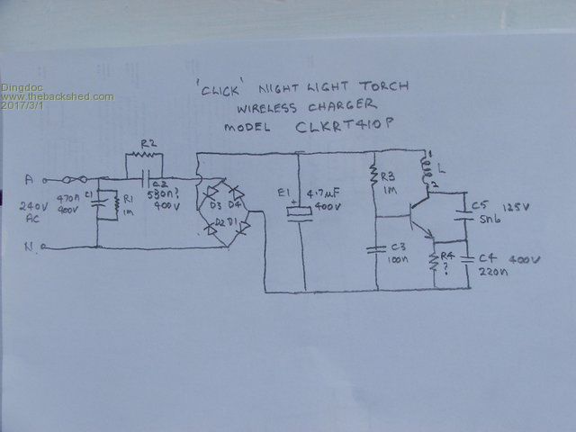

I have traced out and attached the charger transmit circuit and included a couple of photos in the hope that someone will either have one of these and can have a look inside or otherwise be able to deduce the value required for the cooked R4.

Forgot to give the transistor specs in the last post -
It's an MJE13001 400V (CEO) 750mW 200mA.
It looks like the whole circuit runs at a quite high voltage!
The inductor has a ferrite ring 'side-on' in the coil former to improve magnetic coupling with a similar 'secondary' coil in the torch.
Note that the cover is held on by 4 screws under plugs and hooks either side of the coil.

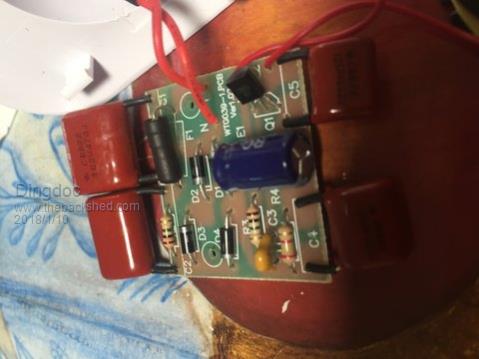

Success at last!
After nearly 12 months wait I finally managed to get details of the cooked resistor.
Friends in the city happened to have 2 of these , one of which had 'died' just like the one I already had, and they sent me a good clear photo of the internals as well as the dead unit!
So, the cooked resistor would appear to be 2k4!
This was easily replaced but a check of the electro and transistor revealed they were not too healthy so I ordered some replacements online.
When the parts arrived and were fitted it was dis-appointing to find the charger would still not work, but a check of the transistor with the component tester revealed that its pins were BEC instead of ECB like the original!
Once it was reversed everything worked as it should and I quickly had the second one working too.

This probably way too late but having had one of these passed to me by a neighbour I went through much of which has been written here but believe some of the advice given does have problems. I needed the value of the burnt resistor which I found on another site but the damned thing still didn't work so I took another link to get here.
I did replace the resistor with a much higher rated one which got too hot to touch so I replaced the transistor which also got hot. So I then did what I should have done as a matter of course and checked the reservoir electolitic, the biggest cause of countless problems which have caused expensive gear to be dumped in frustration and it was of course open circuit. So ....
Replace all three components. The transistor may have survvived because the resistor failed first. DO NOT USE over rated resistor because it may cause a FIRE before failing. The replacement transistor will probably need to be reversed so identify the base first.
It might be an idea to put 2 capacitors in parallel to improve reliability as 8uF will not affect operation.
