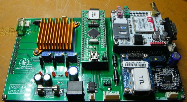

Does anyone here have a link to a GOOD QUALITY, very strong 3mm thread cutter?
I have already broken two of the ones I have here - cheap and nasty though, so I kinda expected it. Even at 3mm, you have to apply quite a bit of torque to cut the thread through 5mm thick aluminium, and the cheap thread cutters I have just shear off - totally useless. The ones I have been using just snap anyway, even with very slow speed and I even tried using cutting oil too. Part of the problem is that 3mm is a very small thread to cut, and so the cutter itself has to be VERY strong to stop it snapping under the strain.
So, I was kinda hoping that someone here might be able to link me to a good quality and very strong one that WON'T shear off while cutting the thread through the hole, or perhaps suggest a different method for doing the same thing.
Have to cut a thread, as it is a finned heatsink, and you can't get at the other side of it to use a nut and bolt arrangement, so you really do have to cut a thread and use 3mm bolts. Can't use 4mm - not enough room, has to be 3mm. Can't find any self-tappers that are long and skinny or I could use them perhaps.
Anyone got any bright ideas?

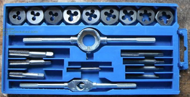

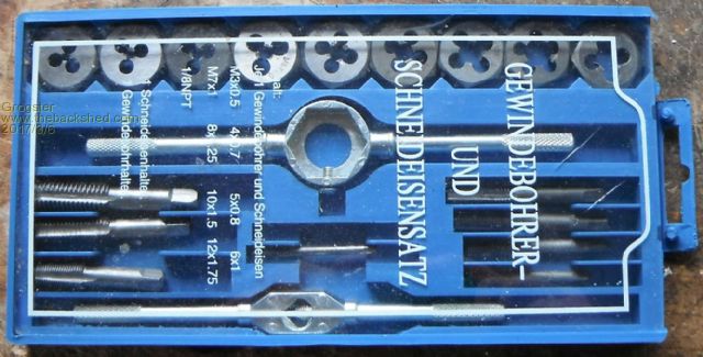

Yeah, I was just using the "Black" metal taps, and they are bloody useless.
They come as one final thread size only - no starter, no 2nd, no 3rd, just the final 3mm size and that's it. They are cheap rubbish, and I fully acknowledge that these are probably best thrown into the skip right now.....
I will see if I can find any of those brands on the web - hopefully one of them has a webstore. Not sure where I could find something precision like this here in NZ, cos our hardware stores only have the cheap crap.
So, in other words, I was trying to tap the 3mm thread directly, in ONE operation, with ONE tap, which was the full 3mm size. Obviously, this is NOT how it should be done, so I need something of better quality and precision, so I can do holes like this correctly from now on.

[Quote=IanT]I'm still not clear if you can "tap through" or not (if it's a closed hole you cannot do so of course) - but if you can, then the 'starter' (No1) tap will usually have a full thread at the back end, so will be the only one required - IF you can screw/tap it fully home.[/Quote]
Closed hole in this case. Finned heatsink:
There is a fan that goes on the top of the heatsink, but this is not shown.
The two 3mm bolts secure the three regulator IC's to the bottom of the heatsink, using a bit of 3mm aluminium plate as a load-spreader/clamp thing. Naturally, there is also a heatsink gasket under the regs so the tabs don't short on the heatsink, as they are 350T regulators, and the tabs are at output voltage.

This is the crappy set I have:

  Quote   Finned heatsink:
Tapping into these is a guaranteed way to break taps unless you can get the drill to come out exactly between the fins.
The drill goes through but flexes as it hit one side of the fin i.e. the hole isn't true. The tap tries to follow and breaks - been there done that - got the tee-shirt
