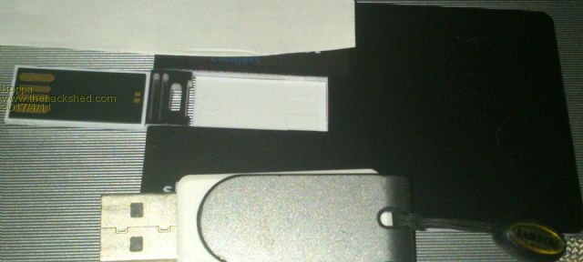

The car uses usb sticks for music, what do people use cd's for these days when there are 1tb hdd that are only $70- jeez what was the limit on cd's 700megs??
I was given a 8gb usb `creditcard' as a promotional gift the other day- for free
(edit sorry it was only 4gb, not 8)
(I covered over the company branding on it just in case)
