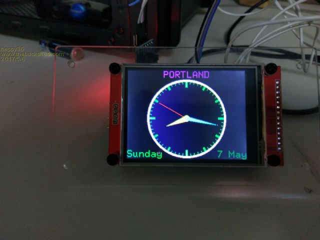

Hi After using my micromite backpack for a while,I decided to turn it into the superclock,I bought the correct RTC,uploaded the Bas file,when I run it I just get errors?
Error: Invalid font #2 and it wont run?have I missed something?
Thank you
Martin
Heppy

I just downloaded the Superclock program from the website,it come with 2 files SuperClock.bas and SuperClockFonts.bas,am I ment to run them together or something?
I have tried runing both of them with no luck (both come up with errors)
Heppy

The procedure is reasonably straight forward:
• Using AUTOSAVE or XMODEM load the file SuperClockFonts.bas into MMBasic and then save it to the library with the command LIBRARY SAVE.
• Then using AUTOSAVE or XMODEM load the file SuperClock.bas into MMBasic and issue the command RUN.
You need to do this because the combined program+fonts are too big to fit into the memory at the same time. When you load the fonts only into the library they are compressed which then leaves you with enough free memory to load the main program.
Geoff

I used xmodem and sent them both to the chip,can I move it into the library from here.or do I delete and start again?
Thanks for the help
Heppy
Posts: 3362
Posted: 12:41am 05 May 2017
Delete and start again (use the NEW command to do this).
Load the font file first and use LIBRARY SAVE. After that load the program file and RUN the program.

What you need to do, is first send SuperClockFonts.bas to the Micromite.
Then got to the command prompt & Type Library Save.
That moves SuperClockFonts.bas to the Library area.
Then send SuperClock.bas to the MM & just run it.

I cant get back into the maximite,on reset I do the ctrl-c but it wont let me type anything,I can see the light flashing when I type its like the maximite is not talking back.I get the error on the screen
> Micromite MKII MMBasic Ver 5.2
Copyright 2011-2016 Geoff Graham
[304] Text MM.HRes/2, 5, " " + Title(ClockNbr) + " ", CT, 2, 1, c.title, c.background
but I cant take control?
Heppy

The program SuperClock.bas has the option of AUTORUN ON. This is what is causing the trouble for you. Have you considered reading the manual?

Do you have OPTION AUTORUN ON set?
Don't set that until you are sure every thing is working.
Do you have a display connected and configured?
There have been some instances where a lack of display when it is configured for one causes issues.
From page 16 of the micromite manual:

heppy36
Joined: 29/07/2011
Posts: 54
Posted: 10:22pm 05 May 2017
Thank you ,that worked a treat,the screen is white on the maximite and I back to the
On the terminal
Not sure if my usb serial my have died,when I type nothing comes up (in tera term),the light flashes on the usb adaptor and I do get the command prompt?
Thanks again for the help (sorry for been a noob)thought it was straight forward

Ok it was my adaptor,and I got it all clean
If I open mmedit and paste in the code the superclockfonts.bas ,then list it il looks like
> list
DeF50000000000000 0000 0000 08111 000000000001001100 00000 0000
18 00F80300 0011000600000
40 B8 701C0E60 E80C800 00000 00000 000000000000000000 0000
00C0FF01C011000 00000 00001011110000000 0000 0000 00000 0000000000030000
0100C001 C00CC01101FF00 0000
000000000 00000000000F00FF0 0000 7700 7C800000EE76000000000F0C 00000 0
0E007F0E
00000000
EC0 0EC0000E 0 7CF0 00000 030000000000000000 00011 C666
E0000070 00088000 000 00
000000080 00C00F0C 00000007 00000000
not what it should look like?
Heppy

heppy36
Joined: 29/07/2011
Posts: 54
Posted: 12:33pm 06 May 2017
Thanks ,turns out the file I was send was corupt,I re download all good
Heppy
