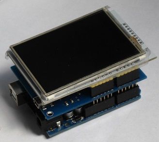

I have been trialling using a lcd for a while. The intent is for a small display
for user on-going info and simple control via selections etc.
[The background idea was, to separate the display/presentation tasks from the main processing, but to keep the information/context on the screen tightly bound with the machine state changes and user control - well that is the excuse. ]
A simple protocol is all that is needed, I used SPI (that is, serial peripheral interface, not espionage ) and it is working OK. So, a client display hangs off the main pcb on a spi port and has data sent to it, and sends back the user selections etc as they are made.
In this case the main board is a pic32mx170 running a simple A/D acquisition on two pins, corresponding to say voltage and current measurements. (A "burst" A-D mode can be used for much faster data acquisition, or say a pic32MZ instead obviously).

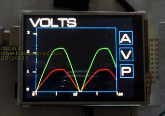

The program scales and sends data to the display via spi exchange, as sequential y data points (mm).
DO WHILE ( i < 121 )
val = FLOAT ( dat(i,1) )
val = val * sclfac
mm = IFIX val + 32
CALL xsptek ( nn, mm, bt )
The default sends the two channels as two lines. The data is offset 32 to move it out of the ASCII control codes. The display program is directed by some embedded control codes.

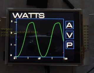

The user can select option A,V,P (amps, voltage,power) on the touchscreen and the
choice is sent back to the main program. This alters the program flow accordingly. So, if "P" (power) is selected, instead of the volt and amp values being sent, the program multiplies the two data points
(amps, volts) to give the power value, and the result is scaled and sent.
val = FLOAT ( dat(i,1) ) * sclfac
val = FLOAT ( dat(i,2) ) * sclfac * val
val = val * 0.02
mm = IFIX val + 32
and the display now shows the power instead

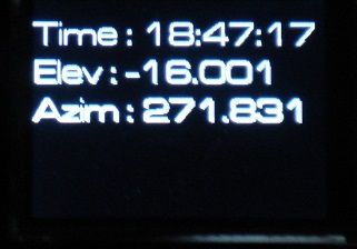

The default text mode is useful as a plain display.
The arduino does the screen stuff leaving the pic free for the numeric work.
As a trial I hooked up the pic ('170) to a GPS (serial 9600),
using current latitude/longitude/time as inputs to calculate solar elevation and azimuth, and sending the text output to the arduino/lcd via a spi port.
It updates every second or so, and looks a lot better than the 16x2.
(Sorry my photo is blurred )
(ed - and yes, the photo is after sunset )

So, the volts 0.174 trace above (leaving out the buttons)..runs using this code, written in an ancient language using simple delays.
It would be easy to calculate say actual RMS values on the fly.

This sketch is a standalone demo. It runs on a uno with a parallel drive 240x320
lcd shield eg from Jaycar. In the code, values are put into the buffer artificially instead of from the spi client interrupt. It runs a slow sweep (approx ten seconds) using the analog value from A5. (It is deliberately plain and simple, and is not meant as an example of the best way to achieve a sweep display, but may be of interest.)
For this - The buttons are cosmetic only. The touchscreen parameteres will
probably have to be tweaked, and I set the font back to a standard one.
It is not polished as I have had eyesight probs lately (pending fixing)
and it will have to do. The suggested name is Vit10demo1,
copy/paste into a new sketch and use "save as" .

strcpy(obj4.newtxt, "b" );
strcpy(obj4.oldtxt, "b" );
strcpy(obj5.newtxt, "c" );
strcpy(obj5.oldtxt, "c" );
strcpy(obj6.newtxt, "d" );
strcpy(obj6.oldtxt, "d" );
tft.setTextColor(WHITE);
for ( numobj = 0; numobj < maxobj; numobj ++ )
if (screen[numobj].flags.visible == 1)
if (screen[numobj].obtype == 1) // 1 = text
tft.setCursor(screen[numobj].xloc, screen[numobj].yloc);
tft.println(screen[numobj].oldtxt);
else if (screen[numobj].obtype == 2) // 2 = button
tft.setCursor(screen[numobj].xloc + 6, screen[numobj].yloc - 10);
return;
void updatescreen() {
byte nxtchr = 0;
byte linenum = 1 ;
if ((screen[numobj].flags.repaint != 0)
&& (screen[numobj].flags.visible == 1))
if (screen[numobj].obtype == 1) // 1 = alphanumeric field
if ( strcmp (screen[numobj].oldtxt, screen[numobj].newtxt) != 0 )
nxtchr = 0;
while ( screen[numobj].oldtxt[nxtchr] ==
screen[numobj].newtxt[nxtchr] )
tft.print(screen[numobj].oldtxt[nxtchr]);
nxtchr ++ ;
tft.setTextColor(BLACK);
while ( screen[numobj].oldtxt[nxtchr] != '\0' )
nxtchr ++ ;
tft.println(screen[numobj].newtxt);
strcpy(screen[numobj].oldtxt, screen[numobj].newtxt);
if (screen[numobj].flags.enabled == 1)
objboilerplate ( numobj );
tft.print(screen[numobj].newtxt);
else if (screen[numobj].flags.enabled == 0)
{ tft.drawRoundRect(screen[numobj].xloc,
(screen[numobj].yloc - screen[numobj].ysize),
screen[numobj].xsize, screen[numobj].ysize, 8 , GREEN );
tft.setTextColor(DIM);
screen[numobj].flags.repaint == 0 ;
else if (screen[numobj].obtype == 3) // 3 text block (/menu)
nxtchr = 0;
tft.setFont();
// tft.setFont(µgmm18pt7b);
tft.setFont(&FreeSans12pt7b);
tft.fillRect(screen[numobj].xloc + 1,
(screen[numobj].yloc - screen[numobj].ysize + 1),
screen[numobj].xsize - 2, screen[numobj].ysize - 2, BLACK );
screen[(linenum ++ + 1)].yloc - 10);
while ( nxtchr < count )
tempchar = stage[nxtchr];
if (tempchar == 13)
if ( screen[numobj].flags.text == 1 )
+ linenum ++ * 28);
else // menu vertical
else
tft.print(tempchar);
nxtchr ++ ;
objboilerplate(numobj);
tft.setFont(&FreeSans18pt7b);
else if (screen[numobj].obtype == 4) // 4 text block (menu)
nxtchr = 0;
//tft.setFont();
if (tempchar == 13)
else
nxtchr ++ ;
//tft.setFont(µgmm18pt7b);
// tft.setFont(&FreeSans12pt7b);
else if (screen[numobj].obtype == 5) // 5 = sweep
yl = atof(screen[numobj].newtxt) / 3.3 * 180 ;
rx = 31 + j ;
ry = 222 - yl ;
darkry = dark[j];
if ( j == 0 ) {
oldrx = 31 ;
oldry = ry ;
darkry = ry ;
darkoldry = ry ;
tft.drawLine(oldrx, darkoldry, rx, darkry, BLACK);
// tft.drawLine(oldrx, oldry, rx, ry, RED//);
tft.drawLine(oldrx, oldry, rx, ry, GREEN);
oldrx = rx ;
oldry = ry ;
dark[j] = ry ;
darkoldry = darkry ;
j++ ;
if (j == 239 )
j = 0 ;
else if (screen[numobj].obtype == 6) // 6 = trace
j = 0 ;
nxtchr = 0 ;
yl = stage[nxtchr] - 32;
rx = 30 + j * 2 ;
ry = 222 - yl ;
// if (ry > 200 ) ry = 220 ;
darkry = dark[j];
if ( j == 0 ) {
oldrx = 30 ;
oldry = ry ;
darkry = ry ;
darkoldry = ry ;
if (nthtrace > 0 ) {
oldrx = rx ;
oldry = ry ;
dark[j] = ry ;
j++ ;
if (j == 120 )
j = 0 ;
nthtrace ++ ;
nxtchr ++ ;
screen[numobj].flags.repaint = 0 ;
nthrecin = 0;
//memset(stage, '\0', 120);
return ;
void act_stateA() {
return ;
void act_stateB() {
return ;
void act_stateC() {
return ;
void act_stateD() {
return ;
void boilerplate() {
byte numobj ;
tft.fillScreen(BLACK);
//outlines
if ( screen[numobj].obtype == 2 )
if ( screen[numobj].obtype == 3 )
tft.drawRect(screen[numobj].xloc,
screen[numobj].xsize, screen[numobj].ysize, RED );
if ( screen[numobj].obtype == 5 )
screen[numobj].xsize, screen[numobj].ysize, BLUE );
// tft.drawLine(31, 223, 31, 40, BLACK);
axetics();
if ( screen[numobj].obtype == 6 )
axetics();
return ;
void objboilerplate ( byte nthob )
if (screen[nthob].flags.visible == 1)
if ( screen[nthob].obtype == 2 )
tft.drawRoundRect(screen[nthob].xloc,
(screen[nthob].yloc - screen[nthob].ysize),
screen[nthob].xsize, screen[nthob].ysize, 8 , GREEN );
if ( screen[nthob].obtype == 3 )
tft.drawRect(screen[nthob].xloc,
screen[nthob].xsize, screen[nthob].ysize, DIM );
if ( screen[nthob].obtype == 5 )
screen[nthob].xsize, screen[nthob].ysize, BLUE );
//tft.drawLine(31, 223, 31, 40, BLACK);
axetics();
if ( screen[nthob].obtype == 6 )
axetics();
void axetics () {
// vert axis tics
tft.drawLine(20, 222, 30, 222, WHITE);
tft.drawLine(20, 167, 30, 167, WHITE);
tft.drawLine(20, 113, 30, 113, WHITE);
tft.drawLine(20, 59, 30, 59, WHITE);
//hori tics
tft.drawLine(30, 223, 30, 230, WHITE);
tft.drawLine(90, 223, 90, 230, WHITE);
tft.drawLine(150, 223, 150, 230, WHITE);
tft.drawLine(210, 223, 210, 230, WHITE);
tft.drawLine(270, 223, 270, 230, WHITE);
// tft.print("0", 20, 225);
// tft.print("10", 140, 225);
// tft.print("20", 260, 225);
// tft.print("ms", 275, 215);
tft.setFont();
tft.setCursor(3, 210);
tft.print("0");
tft.setCursor(3, 155);
tft.print("1");
tft.setCursor(3, 100);
tft.print("2");
tft.setCursor(3, 45);
tft.print("3");
return;

The self-running example runs with just the arduino / genuino uno and parallel drive lcd shield.
The lcd shields are cheap on the net. Adafruit originally had a parallel drive lcd shield version but changed it to back to serial, I used one from Jaycar ie
parallel lcd
which has the blurb and libraries etc as well
