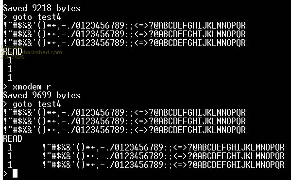

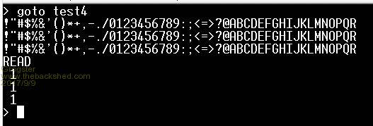

Posts: 6538
Posted: 05:24pm 24 Jul 2017
My 11AA160 TO-92 arrived today.
Testing on a MX170 running 5.0404
Clear to all zeros works.
Clearing to all FF works.
Writing strings or numbers of any length fails.
Reading any length works.
I did notice that reading to a string variable, you end up with a 255 character string padded with zeros.
You have to do a LEFT$() to tame it.
I put a 0.01 capacitor across the supply pins close to the chip.
I put the cro on and did some experimenting with different values of pull-up resistor.
With no resistor, one direction goes from ~zero to a high of ~2.5V
With a 10k pull-up it goes from ~0.5V to 3.3V
That seems to agree with the data sheet.
I tried a 100k resistor and got close to full voltage swing so will stay with that.
Unfortunately, nothing gets the write data to work.
I will try with a different micromite (Explore64) later.
