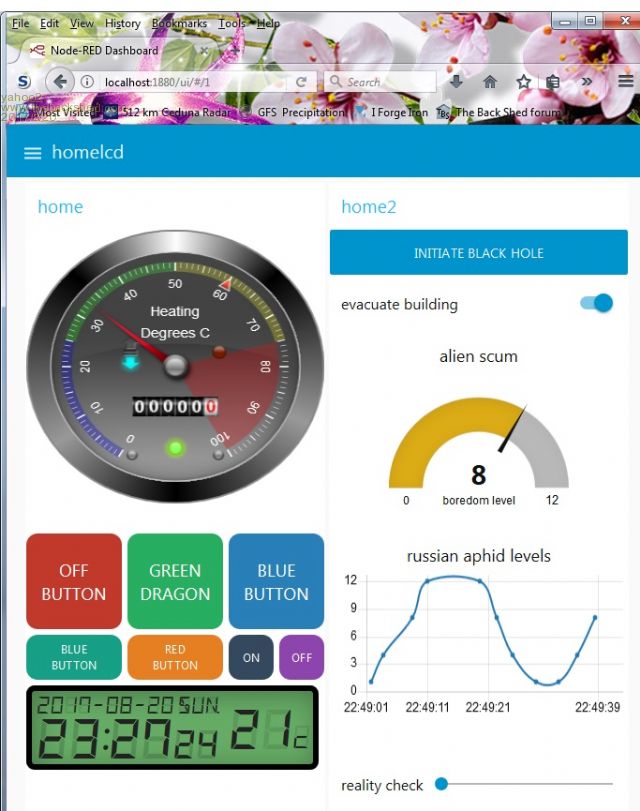

I had a bit of a play this weekend.
I used node-red to practice building some dashboard components.
All the stuff on the left is javascript coded templates by peter scargill, I just plonked it in, set up the directories and fiddled with it a bit. It still took me ages to get it running. I had to modify a file or three by hand and load stuff from a command line.
The right hand side is 10 minutes with node-red myself just chucking stuff together to see what happens.
I guess the next step is driving some outputs from the screen and showing states of the switches and perhaps grabbing some real data.

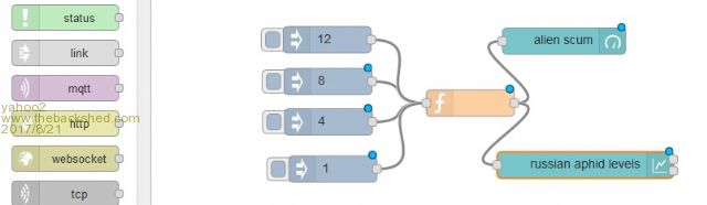

The reason I use crazy headings is that it is tough to see what effect something has if I cant remember where the hell I wrote that input.
So for the gauge and the chart I have 4 buttons that pass a value to both, push a button and the needle swings and the chart updates. It is drag and link then fill in the details on a drop down menu for each node.
I could have added the buttons to the dashboard page and triggered them from there or linked it to one of the sliders but I had run out of puff at that stage. You can see the nodes on the left, they just drag and drop on the page.

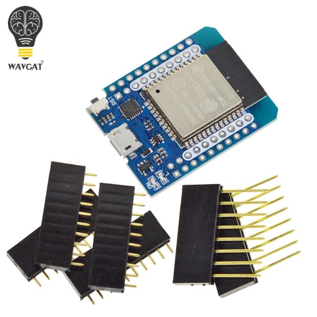

For the peripheral devices and controllers it is probably going to be some hacked ESP32 and ESP8266 wifi boards running python3 some z-wave stuff and some arduino units.
The great thing about the ESP boards is that if the have enough space in the memory to load an upgrade while operating on the old version it is possible to do over the air (OTA) wifi upgrade, the great thing about that is that I can mount stuff permanently, I dont have to isolate it from the 230 volt AC and reach in with a 4 pin plug to reflash them, upgrades can be rolled out over the network.
I think the ESP32 development board is going to take some beating it has heaps of pins plenty of memory, the newer ones have a decent antenna and bluetooth and wifi built in.
It can run pretty much anything directly from the chip, I have seen one send a live camera feed 600 meters.

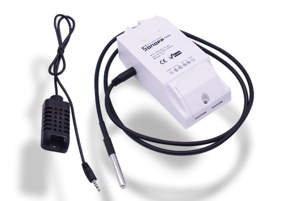

All the Itead sonoff wifi switches can be reflashed so they no longer need the cloud and can be controlled/ served MQTT locally behind the firewall.
this model, TH16 will switch 16 amps on the relay has not bad isolation in the design, can input a couple of sensors output everything to wifi and can be had for twenty bucks. I can even wire the old manual switch to a pin or maybe a capacitive button to toggle the relay.
There is a thermostat right there! or a motion sensor!

yahoo,
I think that is a humidity sensor.
