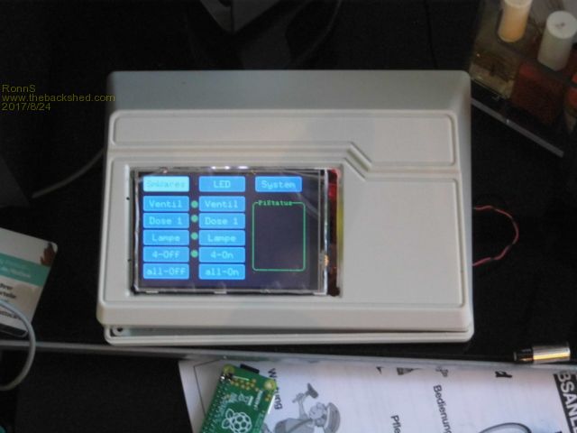

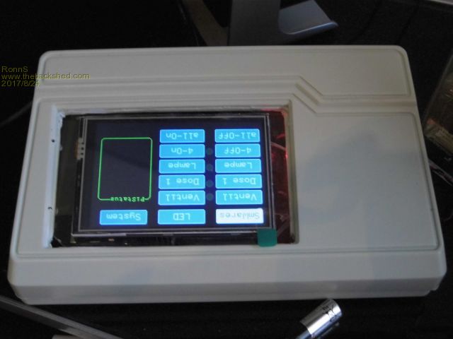

Posted: 09:00pm 23 Aug 2017
hi Peter..,
I wanted to use it as mmbasic display
First I tried it with a zero W-
today I tried it with a RPi 3 and its working
this pic shows the 3.5 Zoll LCD with an RPi3
I think the Zero-W is broken
and this pic shows the 4 Zoll LCD with an RPi3
if someone is interested in it the casing is from Combiplast Link

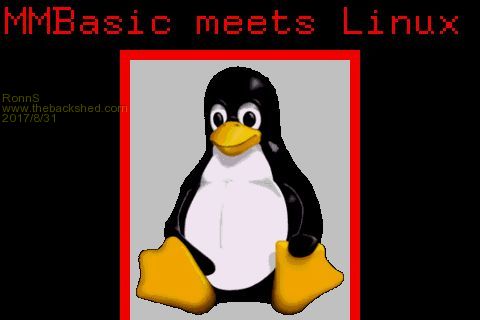

RonnS
Joined: 16/07/2015
Posts: 123
Posted: 11:06am 31 Aug 2017
wow what a speed
im happy..... so it was very slow at last mmbasic version on the Raspi Zero
thank you very much Peter
RonnS
Joined: 16/07/2015
Posts: 123
Posted: 11:31am 31 Aug 2017
this Pic i have made with "SAVE IMAGE" from the 3.5 inch display we talk about above
and a Raspi 3
the salesman wrote me it has an ILI9486 Chip
Edited by RonnS 2017-09-01
