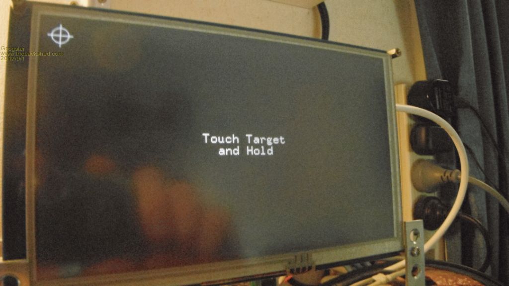

I'm trying this a step at a time
I have 3 boxes drawn on the screen and I have the program set at the moment (in theory) to just print which box I touched
What is happening at the moment is the clock stops so I can see touch is working - but its when I touch anywhere on the screen and not just in the boxes and nothing is printed
[code] GUI DISPLAYBOX #25, 560 ,295,170,50,RGB(BLACK),RGB(RED) 'displaybox "Tomorrow"
GUI DISPLAYBOX #26, 560 ,355,170,50,RGB(BLACK),RGB(GREEN) 'displaybox "Day 2"
GUI DISPLAYBOX #27, 560 ,415,170,50,RGB(BLACK),RGB(BLUE) 'displaybox "Day 3"
ctrlval(25)="Tomorrow"
ctrlval(26)="Day 2"
ctrlval(27)="Day 3"
GUI INTERRUPT PenDown
'Main program
'end of main program
SUB PenDown
IF Touch(X)=560 AND Touch(X)<730 AND Touch(Y)=296 AND Touch(Y)<345 THEN 'If Touch pressed
PRINT "TOMORROW TOUCHED"
IF Touch(X)=560 AND Touch(X)<730 AND Touch(Y)=355 AND Touch(Y)<405 THEN 'If Touch pressed
PRINT "DAY 2 TOUCHED"
IF Touch(X)=560 AND Touch(X)<730 AND Touch(Y)=415 AND Touch(Y)<465 THEN 'If Touch pressed
PRINT "DAY 3 TOUCHED"
END IF
end sub[/code]Edited by lew247 2017-09-01
Posts: 9975
Posted: 04:36am 31 Aug 2017
Displayboxes are just for on-screen information - they do not respond to touch.
So, your displayboxes tell the user some useful information of some sort, but you need to define some BUTTONS before any touch will result in any result.
Have a closer look at the GUI BUTTON command and syntax.
You should NOT try to detect a touch, on top of a DISPLAYBOX or any other GUI control.
Lets say you have your three displayboxes to tell the user things, but the buttons to touch should be defined separately - six controls in total. Three displayboxes, and three buttons.
I'm not saying you CAN'T detect touch on top of a displaybox as you are trying to do, but I don't think the MMBASIC GUI is designed to deal with that - others will know.
