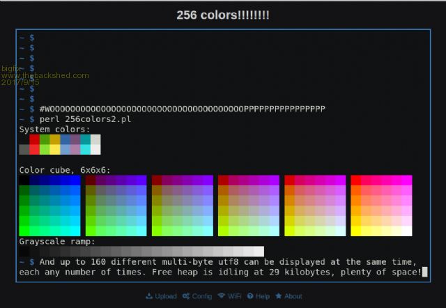

ESPterm is a tiny Webserver running on an ESP8266 which emulates a VT100
ESPterm allows to "webify" any Micromite just with a serial connection and no special Web/Network code at all
This gives you a full character based GUI to the MicroMite with optional touch/mouse support
tiny size, relatively low power
very low costpoint - typically a few $ only
no special SW on the client side - just a browser
no OS patches/maintenance - fits well with MicroMites

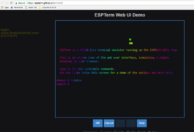

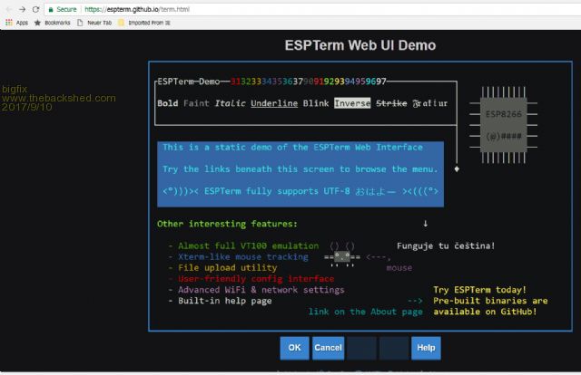

ESPTerm Demo
All the menu/help pages in the demo look exactly the same as the real thing

Features:

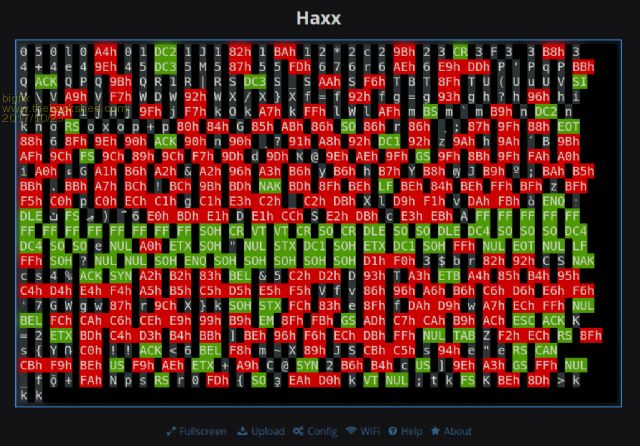

Almost complete VT102 emulation with some extras from Xterm, eg.
Screen size up to 80x25
(Currently no 132 Char Mode & Double Wide/High due to memory restrictions)
All standard text styles and 16 colors supported
Full UTF-8 support, alternate character sets
Configurable mouse support "XTerm Style" - should also work with touchscreens
XTerm Standard mouse tracking modes configurable from serial port
You can dynamically set screen title, button labels from serial port
up to 5 configurable buttons under the screen for quick commands
Real-time screen update via WebSocket - require somewhat up to date browser
Button to open keyboard on Android - use "hackers keyboard app" for full function keyboard
Text file upload tool with configurable delays and line endings
Built-in extensive help page with basic troubleshooting and command reference
Robust WiFi configuration interface
Static IP, DHCP, channel selection, power
SSID search utility for finding your existing network

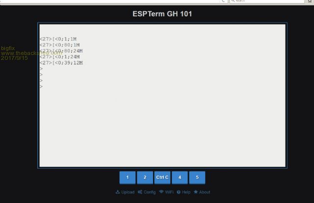

Example Mouse Usage:
To enable the Mouse in normal click mode use:
Print E$+"[?9h"
To disable the mouse:
Print E$+"[?9l"
Left upper corner click delivers:
[M!! = Hex 33,33 minus basevalue 32 gives 1,1
Lower right corner click delivers:
[Mp8 = Hex 112,56 minus basevalue 32 gives 80,24
This allows you to use any location on the screen as an input button

1.1.2 is here !
no further excuses not try it
New more interactive Demo at
ESPTerm Demo
Wifi Bug is fixed
Frontend got completely rewritten - works better across browsers
Chrome still looks best and also has optional fullscreen mode
Uses HTML5 now, faster rendering
256 Colors, Cursor styles
Many more config options in expert settings
For all details see release notes
ESPTerm Latest release
