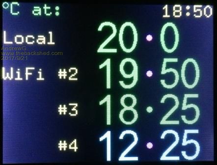

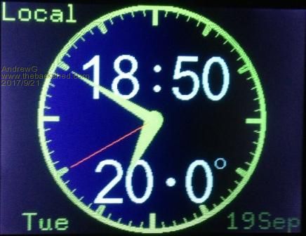

Hi. There are some threads going discussing HC-12s and how to minimise power to remote sensors. I've attached some photos of an LCD backpack running my current version (Mk2) of Ambi-Mon which uses this data from remote temperature sensors (#2, 3 & 4 in the photo below). I'm more than happy to provide details if people are interested. (I must emphasise that it relies heavily on the work of Geoffg and many others on TBS).
I'm awaiting delivery of some weather station sensors (wind/rain/humidity) that will form the basis of Mk3.
Cheers,

Posted: 03:05pm 21 Sep 2017
Very nice.
Posts: 3362
Posted: 08:38pm 21 Sep 2017
Yes, great job. Congratulations. I like how you put the temperature onto the clock dial.

Andrew_G
Joined: 18/10/2016
Posts: 883
Posted: 12:03pm 22 Sep 2017
Thanks folks. I'm away for the weekend and only have limited mobile coverage so I'll give you proper answers on Monday pm.
Geoff - thanks, I created my own font - possibly a little too big? I'll post it when I get to my PC.

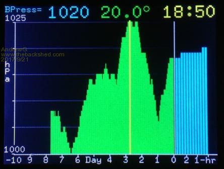

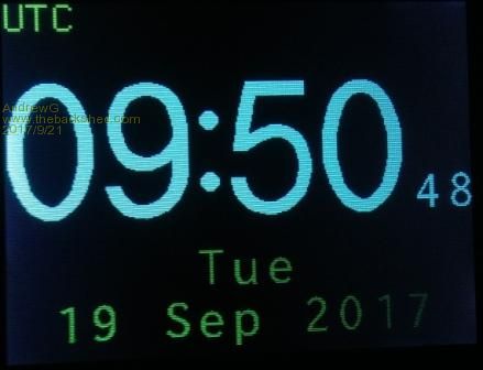

A bit more information about the above pictures:
Temperature - the decimal places in some temperature readings are magenta. I have a count running to show if a reading is overdue (eg all except #3 in this case). If is doesn't revert to the proper colour I go looking - eg has someone turned off that remote's power supply (eg a 5v USB pack or #4 batteries may have died, not yet . . .).
If a temperature is green it is within a (customised) "normal" range, cyan = below and red = above. (ie #4 is below, the others are normal).
Barometric Pressure - you can see that low pressure/cold fronts (ie bad weather for a boatie) came through one and seven and a half days ago. With the barometer dropping I'd be "alert but not alarmed". The baromter has been steady/slighly rising over the last three hours so all is well. The yellow bar near day 3 is where a reading is outside the graphed range - you tap the bottom or top of the screen to change ranges.
The "Local" and "UTC" displays are obvious but I depart from Geoff's approach slightly - using his setup routines I get you to set the local standard time (Australian Eastern Standard Time in my case), and the UTC offset to that. You then set Daylight Saving Time as "On"/"Off" and this adjusts "Local" time accordingly (I doubted I had enough grunt in the MM170 to keep Geoff's automatic DST routine from his Super Clock).
CORRECTION: contrary to what I said above the font used to show the temperature and digital time on the analogue clock is not one of mine but is "ArialNumFontPlus.bas" from the MMBasic distribution - sorry.

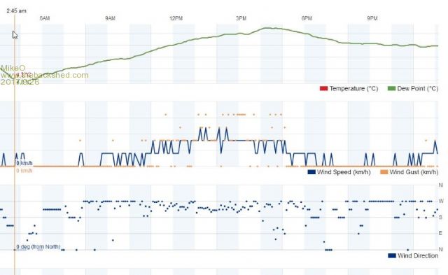

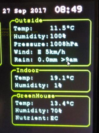

Posted: 01:06pm 26 Sep 2017
I use that weather station and yes it is the same one from Jaycar. Spiders are still a problem unfortunately but OK if you wash it out occasionally. Mine is at low level so its easier.
I have been using this system for a couple of years and its works Ok, I use a micromite with wifi for transmission. You are welcome to use/modify the sensor code .
Photos, Base Station and Weather Underground graph data
Here is the code, I think/hope it is commented enough for you to pick out the sensor bits. Any questions please ask. Mike
