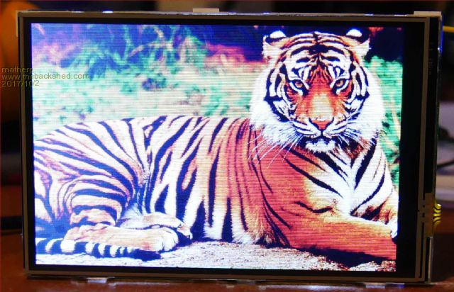

The excellent 480 x 320 IPS 4" ILI9481 displays are directly supported by the MMX and Pi-cromite.
I've now created a loadable driver to use them on the MM2 and MM+. See this thread for connection details.
This was done specifically in preparation for the Micromite pHAT compatible PCB but the display can be used with any Micromite if appropriately wired.
The MM2 version supports all the normal MM2 graphics commands and TOUCH can also be enabled using the normal option command. The MM+ version also supports all the GUI commands and LOAD IMAGE as seen above.
The driver should be stored in the library and enabled with a command in MM.STARTUP
ILI9481 CDpin, RESETpin, CHIPSELECTpin, orientation
valid orientations are : 1=landscape, 2=portrait, 3=reverse landscape, 4=reverse portrait.
Wiring of the touch and SPI pins is exactly the same as an ILI9341 display as detailed in the MM2 and MM+ manuals

Zonker
Joined: 18/08/2012
Posts: 767
Posted: 06:54pm 07 Oct 2017
Wow Peter..! Excellent...
I have the 4" IPS... Will give this some play time...
Thanks for creating the new driver
