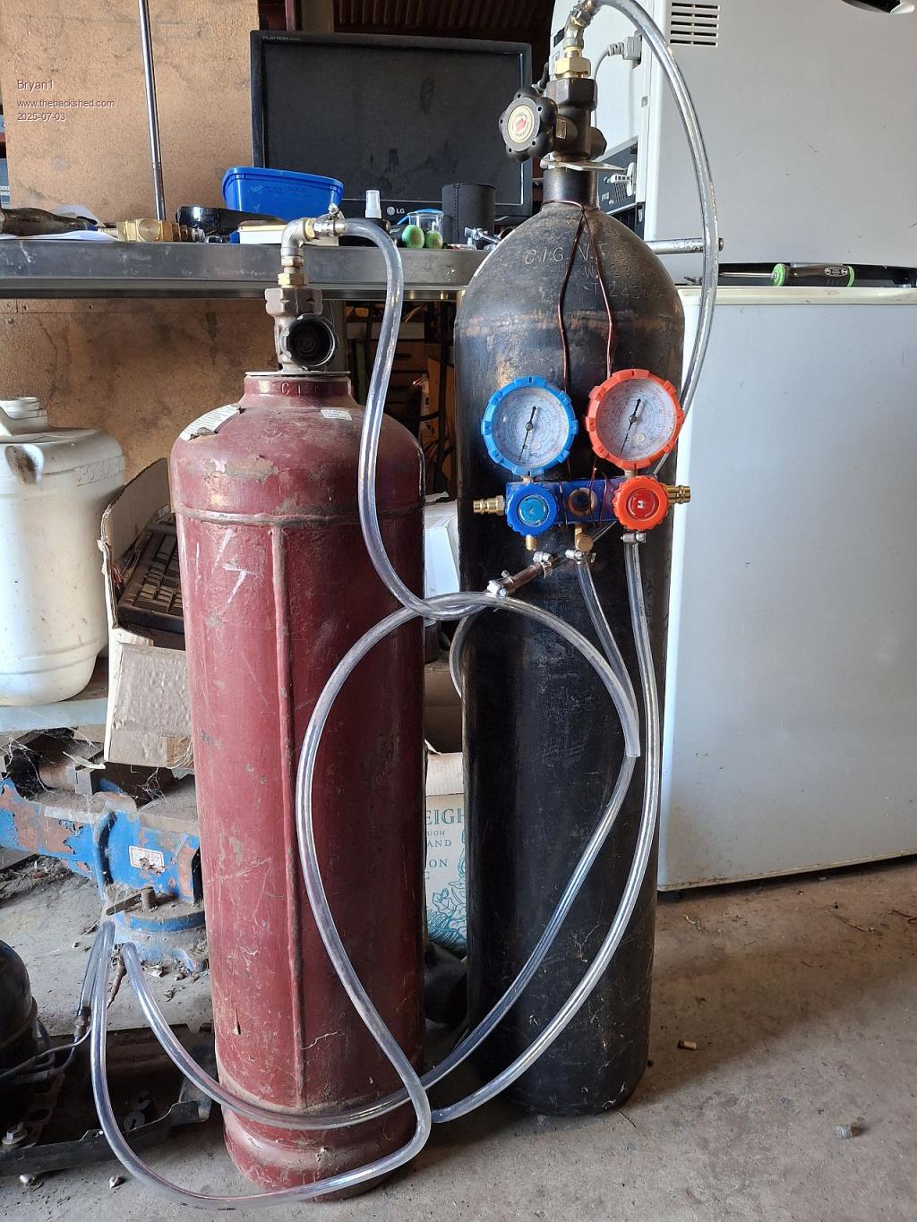

Well Pete it all depends on how much pressure that fridge pump can do so it will be interesting to see how it goes and I may have to machine up a 5 stage pump to get the pressure up.
For a bit of fun I put the acetylene reg on and made sure it was totally closed then when I opened the bottle I could hear a pressure release but nothing on the gauge registered. The E sized bottle is pretty big for what I'm doing and it will take quite a few tubes to get enough to try the oxy torch it is worth persisting.
I am going upto the bridge in the morning to see the BOC bloke as I do need a bottle connection to decanter the Oxy.
Now the hydrogen tube was totally sucked out and laying flat and the power supply is set to 10 volts over night so should see some movement in the morning.
So yes with using hydrogen Oxygen does need to be used to trim the flame and I do have a full E sized bottle here where I'm using LPG with it for silver soldering.
Regards Bryan
Edit: Day 3
Went for a drive to Murray Bridge only to find they only work a 5 day week and everything was shut. On the way home remembered I did have some old regulators so went for a look in my shearing shed when I got home and the one I wanted was just sitting there
After cleaning out all the wasps nest found a 12mm hose fitted straight over the threaded section. This time I put hose clamps on to stop the hoses blowing off and found the oxy bottle still had about 20psi of oxy left.
Decanted the big tube and the fridge pump chugged along all the way to 40psi and I do think it won't pump much more pressure.
I do have a heap of 12 volt seajet pumps that are 100psi rated for water and they are a dual diaphragm pump so I'll see how they go.
Now one important thing I will need are flash back arresters on the hand piece to avoid blow back with the hydrogen.
So I'll just keep collecting gas over the weekend and on Monday I'll get the gas arresters then it may be time to see if I can get a hydrogen/oxy flame going. Edited 2025-06-28 12:21 by Bryan1

As the hydrogen was the last fill just had to connect the hose to the tube and when I opened the valve on the bottle no leaks this time Started the fridge compressor and it easily got the tank to 52psi so pretty happy with that.
Went up to the bridge this morning and got the flash back arrestors and asked about the threaded connectors to the bottles , well after a while I talked them into it so now got one for each bottle with a 1/4" bsp threaded end.
The next decant will be the oxy so I'll make up the proper connection and just see if the fridge compressor will do the next run to 70 psi

G'Day Guy's, Went up the Bridge today and got a couple of 1/4" bsp to 8mm barb fittings and just finished plumbing it up
So now each bottle outlet goes to the Tee piece and I changed over to the high pressure side so now got 800psi on the meter
Now as only one valve will be open at a time the gas will flow to the open one and as one can see the pressure relief valve on the meter unit which will bleed off the pressure when finished.
This setup will do until the fridge pump can't do any higher pressure so it will be interesting to see just how far it can go.

So a bit of an update the hydrogen is sitting on 150psi and after decanting the oxy it sitting on 110 psi.
I do have a full bottle of oxy here so between working on my CNC I may just try and see if I can get a torch going as it will be fun to try.

IMHO hydrogen is dangerous enough already, you are going to have serious accidents.
BTW I see the tank is an old acetylene tank. Acetylene by itself is unstable under higher pressures and spontaneously detonates in a decomposition reaction. It dissolves more safely in acetone. So, commercial acetylene cylinders are largely filled with a porous carrier and acetone, which absorbs/releases the acetylene at a smallish pressure.
So, an acetylene tank won't have much volume to store hydrogen, and is not designed to routinely hold gases at high pressures.
Apart from that, hydrogen has wide explosion ranges in air, a small leak is a disaster waiting to happen.
ed - my urgent advice is, stop using the acetylene tank at pressure. Edited 2025-07-15 18:22 by zeitfest
