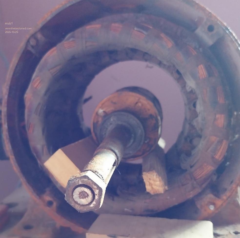

I was thinking i could use the stator of an old larger diammeter 4 pole induction motor as the outer iron and use its coils to provide the 2T, and squeeze some additional windings between it and the magnet rotor - but that means there's a big air gap between the iron and the magnets. Possibly that's ok as i don't want iron where i'm trying to achieve 3T, but then does the ~2T in the iron contribute anything?
Sort of like this, but with two microwave primaries, one each side of the rotor and concentric, in place of the bits of wood.
