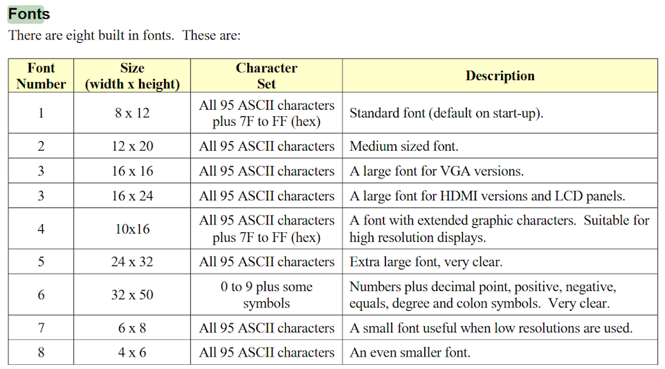

Posted: 12:49pm
11 Aug 2025
Amnesie
Hi Martin!
oh this is awkward! This seems to be from the manual, right? I must have missed, that there is written what Size each font has
I think the best font of all is still FONT 1, (8 x 12). It is the "sweet-spot" between high and low resolution and slightly bigger than the Amiga-Font.
When it comes to your Codepage font - I really have almost no special requirements - except that all ÜüÄäÖöß should be on their correct places when it comes to ASCII values. This prevents re-mapping. Of course this means the Font MUST be a full-size 224 char Font like your Amiga font. It is called " font_Classic
' Font type    : Full (224 Characters)" - just looked it up
I am well aware that this eats memory space - but as said, If one would pack it in the flash library, there isn't a problem.
The font itself should be well readable, maybe an old Windows / (Dos?) font like your codepage font would be ideal - in fact I love that DOS look! About all the other "special" characters, I have no requirements, so you could fill them with the ones you like. As said, only the Umlaute should be an their correct places.
Greetings
Daniel
Edited 2025-08-11 23:02 by Amnesie
Posted: 11:08am
12 Aug 2025
Martin H.
Hallo Daniel,
Here we have a font based on the DOS-VGA characterset with umlauts and 8x12 pixel, i.e. the same size as font 1.
Font_DOS8x12.zip
hope it fits like this
Martin
