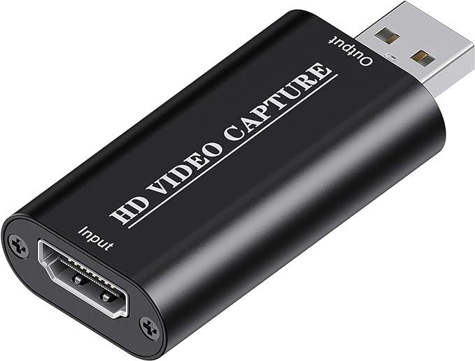

Posted: 01:56pm
08 Dec 2023
PeteCotton
Another advantage of having the HDMI output is that you can feed it directly into an HDMI video capture card on your PC and record rock solid videos of the CMM2 in action - very useful if we want to raise it's profile.
How much are these video cards? Well, I paid $15 for mine about 4 years ago and it still works great. It just plugs into a USB port on your PC and the HDMI cable plugs in the other end.
https://www.amazon.ca/Recorder-Converter-Streaming-Broadcasting-Conference/dp/B0CJ95M7PG/ref=sr_1_2_sspa?crid=2N3YPUGA93Y5E
