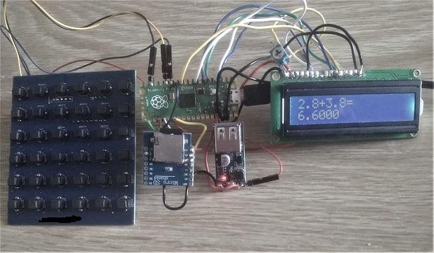

Posted: 10:41am
06 Jul 2025
zeitfest
Tried a version with 16x2 lcd and a 6x6 keypad...works ok so far
(in Salvador Dali air-wired mode  ) but the lcd is a bit
cramped. Less cost though.  I think a bare bones version
with a smaller 6x5 keypad would fit on a 4" pcb.
[showing the pico, sdmicro adapter, keypad and 5v booster with a red led]
ed- changed backlight to 3.3v supply instead of 5v, wire is behind lcd.
replaced photo.
I'll post the keypads if there is interest, they are not complex but might
save some hack work
Edited 2025-07-07 13:19 by zeitfest
