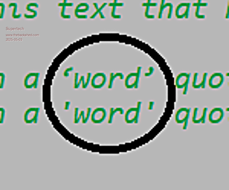

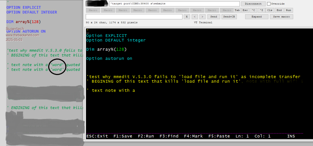

1. 'Load file and Run it' via MMCC.
Now this is tricky to explain, and took me a while to find cause.
1.1 In one word " ' " that is the single quote character itself, nasty.
1.2 Now this ONLY occurs if one pastes from any external text source, so bare with me.
1.3 By default, as one types comments in (Webmite syntax mode I am using) in your .BAS in MM Editor V5.3 console, one gets that single quote belonging to MM Edit font.
eg ' text with 'word' in single quotes GENERATED in MM Edit. All good.
1.4 However, lets paste this identical text in externally as notes.
eg ' text with ‘word’ in single quotes PASTED in MM Edit.
Notice the different? This was never an issue before and especially within a ' text comment that really should be font ignored or inclusive?
1.5 In case you can't see, the single quote is a different style, ' ' vs ‘ ’.  Woopy do hmm? Um, No. It took me by sleuthing, to reveal what was going on.

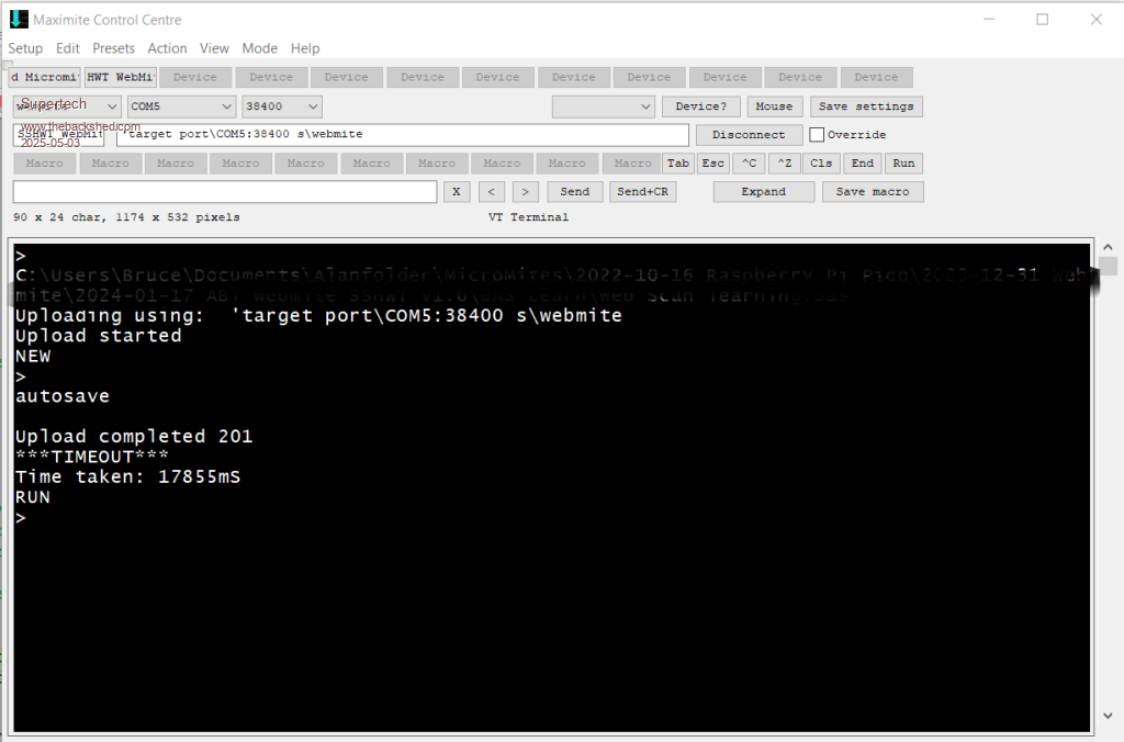

2. Well now try using 'Load file and Run it' icon via MMCC.
Result in MMCC screen,
Upload completed 201
***TIMEOUT***
2.2 AND, No data is transferred from the unhappy character part of your .BAS onward.
2.3 When you type EDIT in MMCC, program transfer shows no data from that point directly off device itself, in my case, irreverent but, Webmite Pico W. It only holds code to 1st font quote it don't like, with blank data onward obviously not....?
3. Undo any history, or in fact mostly any Undo does nothing, in some cases it seems to forget if was stored as a Undo, if it even did, jumping back with whole lump of Undo steps totally missing. Sorry, It don't work, but thank you for fixing Icon!
Warm regards from just above down under. Take Care TJ.   Regards. Supertech.

Lovely, Forum REMOVES illustrated issue, so,
An image says a thousand words! Kind of explains itself.
Posted: 03:35am
03 May 2025
Supertech
A little closer......
Them little quotes are DIFFERENT if unnoticed in the fog of character land....
I give up at this point
Posted: 05:29am
03 May 2025
MMBasic is ASCII only.
If you enter non ASCII, you get problems.

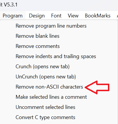

Posted: 10:07pm
03 May 2025
Supertech
Thank TJ for good work.
I see you adding more characters support too.
Good to know 'non-ASCII' will kill transfer.
But as a tip for those like me falling into this issue,
When sending, watching the left code counting vs right sending to device in MMCC,
You Can See a "pause" in transfer which roughly corresponding nearby the line in MMEdit that holds the offending non-ASCII which can then be removed/edited.
When editing a program with say 1140 lines, balkinging at say line 490 this is your give-away place in code to sort.
Hope this helps you and others TJ.
Your editor is overall excellent. Does undo/redo work? Although I notice V5.3.1  as new to me?
Regards TJ. Supertech.
