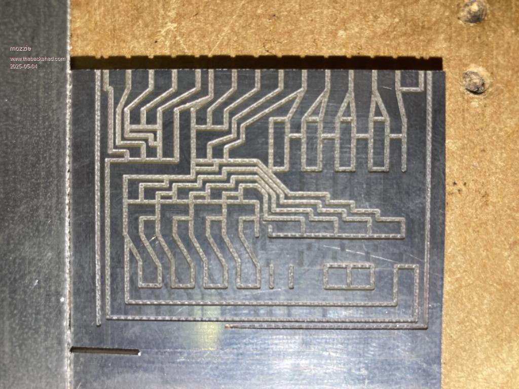

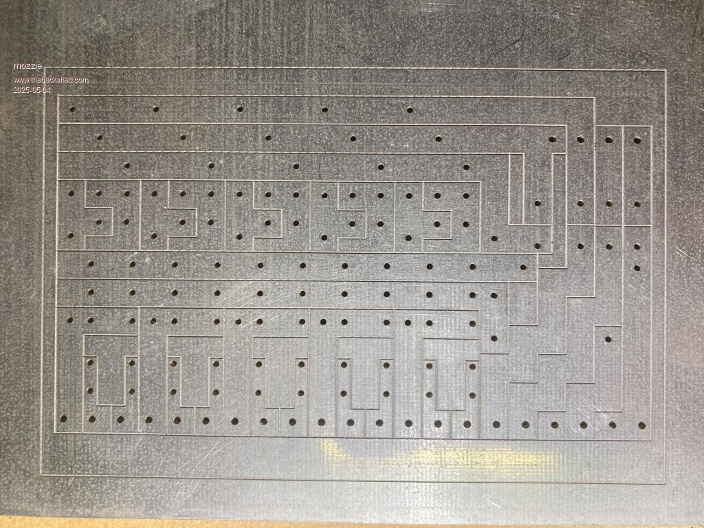

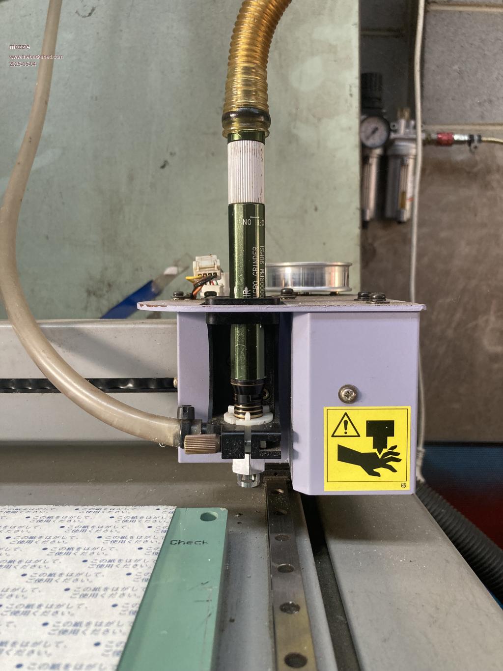

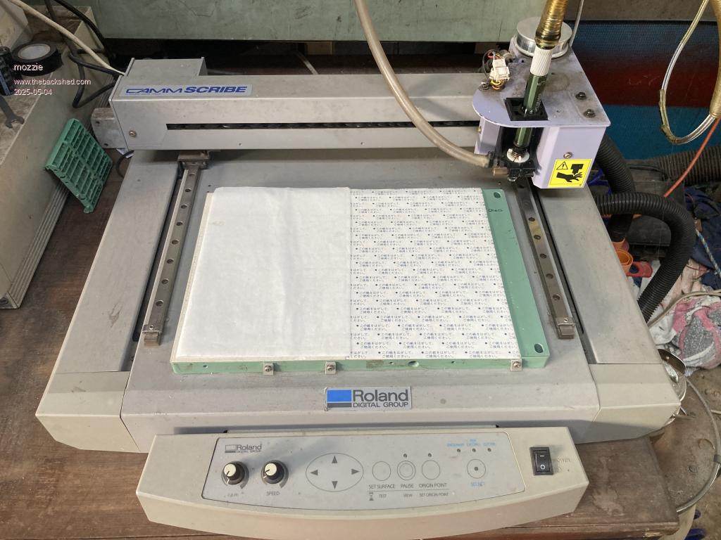

I am very lucky to have a ROLAND CAMM-Scribe CS-20 engraving machine, purchased in approx 1997. This is perfect for making front panels etc with its inbuilt electric spindle drive.
We found that a micro die grinder fits with a small machined adaptor and accepts 1/8 carbide PCB mills and drills, PCB production was now a goer
Software wise, for intricate PCB's I still use CircuitMaker / TraxMaker to draw the design and IsoPro to create the cut paths and drill files. This is all WIN98 era software.
Most of my PCB's are for power electronics / auto electrics so using CAD to draw all the holes, then lines where I dont want copper, and plot direct to the CAMM-Scribe machine, see pic below

Relay PCB for something long ago
Oooops, cutter too wide
28 years old and still going strong
Micro Die Grinder with adaptor
