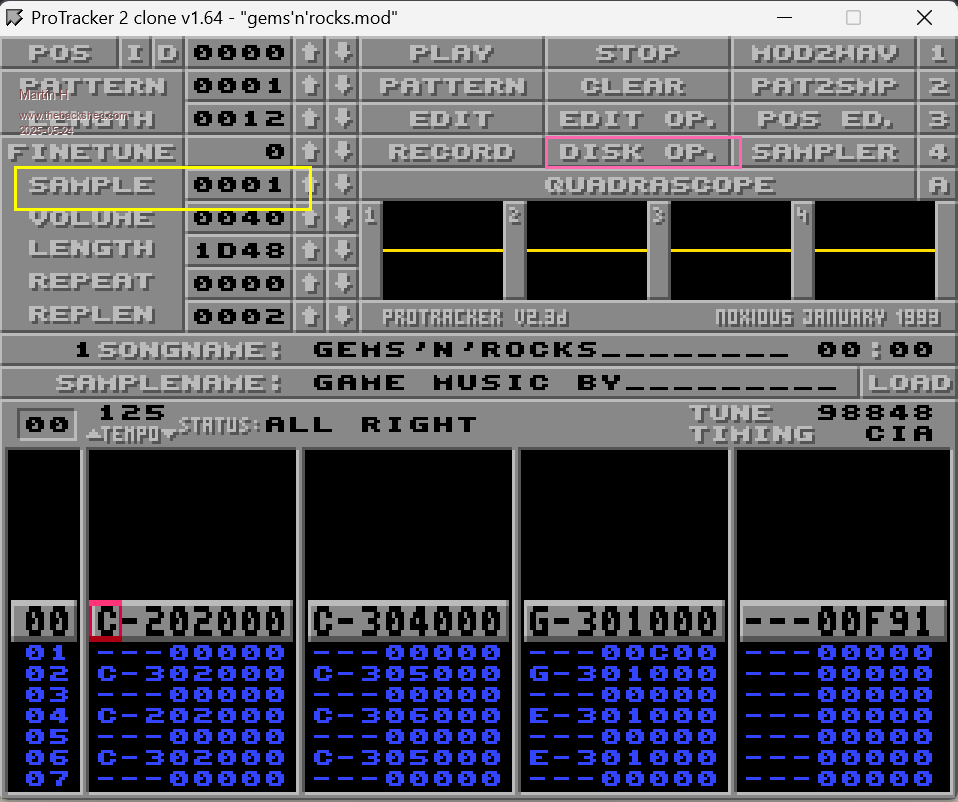

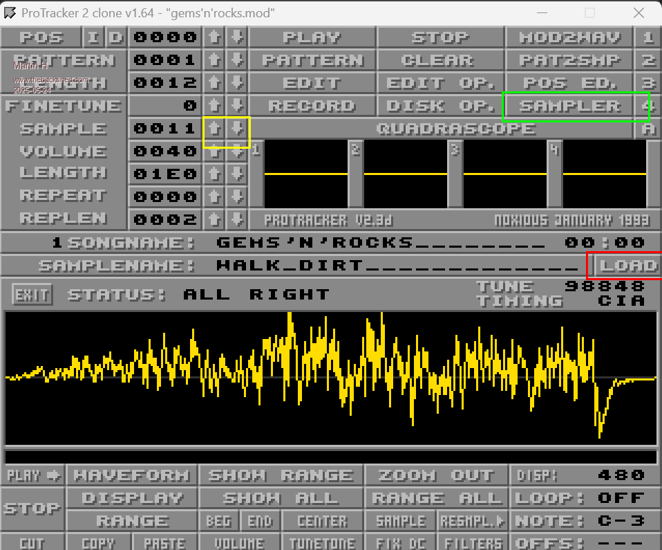

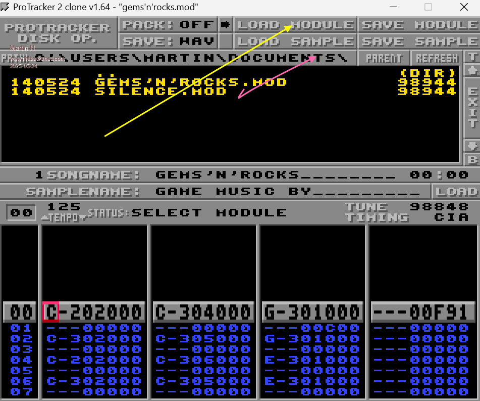

Posted: 10:42am
24 May 2025
Martin H.
  Volhout said  Hi Martin,
When you include a sample in a song, you add a note to it. C or G or A.
How is that when you play a sample with PLAY MODSAMPLE ?
Harm,
if you use 16khz 8 Bit Mono Sample, the default settings should already fit
Goto Disk OP and load your Modul File
Click on the Sampler Button and change the Samplenumber to chouse a empty slot
Then just load your Sample at this slot, close the Sampler and Save the MOD File.
Now your mmbasic Program can play the Sample with the PLAY MODSAMPLE Samplenum, channel.
Samplenum is the number of the slot into which you have loaded your sample,
channel (1 to 4) You can choose this freely between 1 and 4, I would “rotate” the number to make sure that the channel is not already being used by another SFX.
